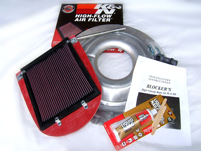

Then there is the air cleaner to deal with. The best plan I have at the moment is to either buy or make something like the following:
My concern is that my throttle body will cause the drop base to be so far up into the shaker that space will be limited. I need to build my base and put it together and find out. I've been dragging my heels honestly because it's a pain and I don't have the ability to do it all myself at home.

Bryan- I was looking at that blockers kit as well. I'm sure you have also heard of WFO sold by Butler.
https://butlerperformance.com/i-2445...html%3Fq%3Dwfo
Or WFO has a blocker style system as well.

I bought the original Blockers popsicle stye and it was junk
It did not even fit right under the shaker.. looks like what
you are looking at is a lot better
I ended up doing something like Byan cutting a bottom plate

I'm leaning on fabbing my own plate - blockers/WFO style such that my shaker can fit onto it with the stainless ring and then use a rectangular KN filter fitted into the shaker itself. When I make the plate I can adjust for tilt and off center. I'm concerned that with the Victor Jr. style intake I have that I'll run out of height- so the rectangular filter appeals to me.
