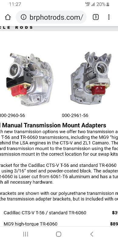

Old 01-28-2020, 08:38 PM
billohio billohio is offline
Join Date: Nov 2019
Posts: 19
Thanks: 6
Here are the 2 mounts I have found showing the difference. What is weird, I have a LSA and 6060 out of a 14 zl1 and I haven't taken the crossmember off yet but I swear it doesnt look like the mg9 on the right
Old 03-22-2020, 07:14 PM
NickBurns NickBurns is offline
Join Date: Sep 2013
Location: Pine Plains NY
Posts: 61
Thanks: 22
Thanked 6 Times in 6 Posts
Thank you ! Yep very odd. I ended up buying the mount cut it apart and made my own! Much better than the one I bought !
