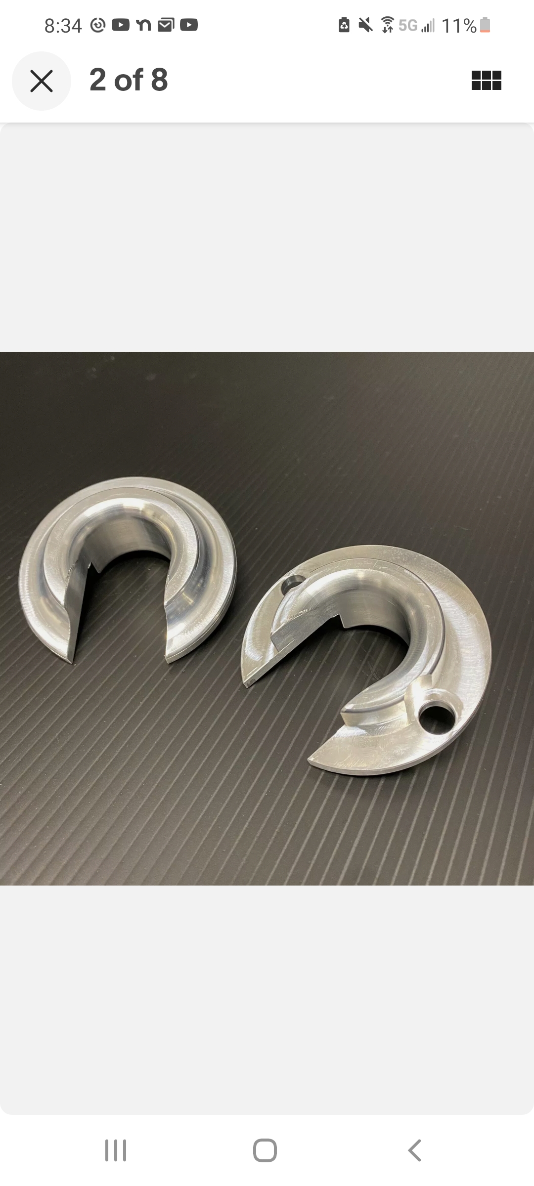

Just wanted to post this up. I was looking for a cleaner way to pass my harness through my firewall. I contact the owner of the business and showed him a design and he was able to produce it. Hopefully this helps others. I am not affiliated with the business or owner .

Thank you!! I use to be heavy into the import scene and a company made these for Honda harnesses but not domestic cars. I contacted the owner of Sharpe performance and told him the potential market for a clean quality pass through and sent him the design you see and literally in a couple a days he had one prototype made.

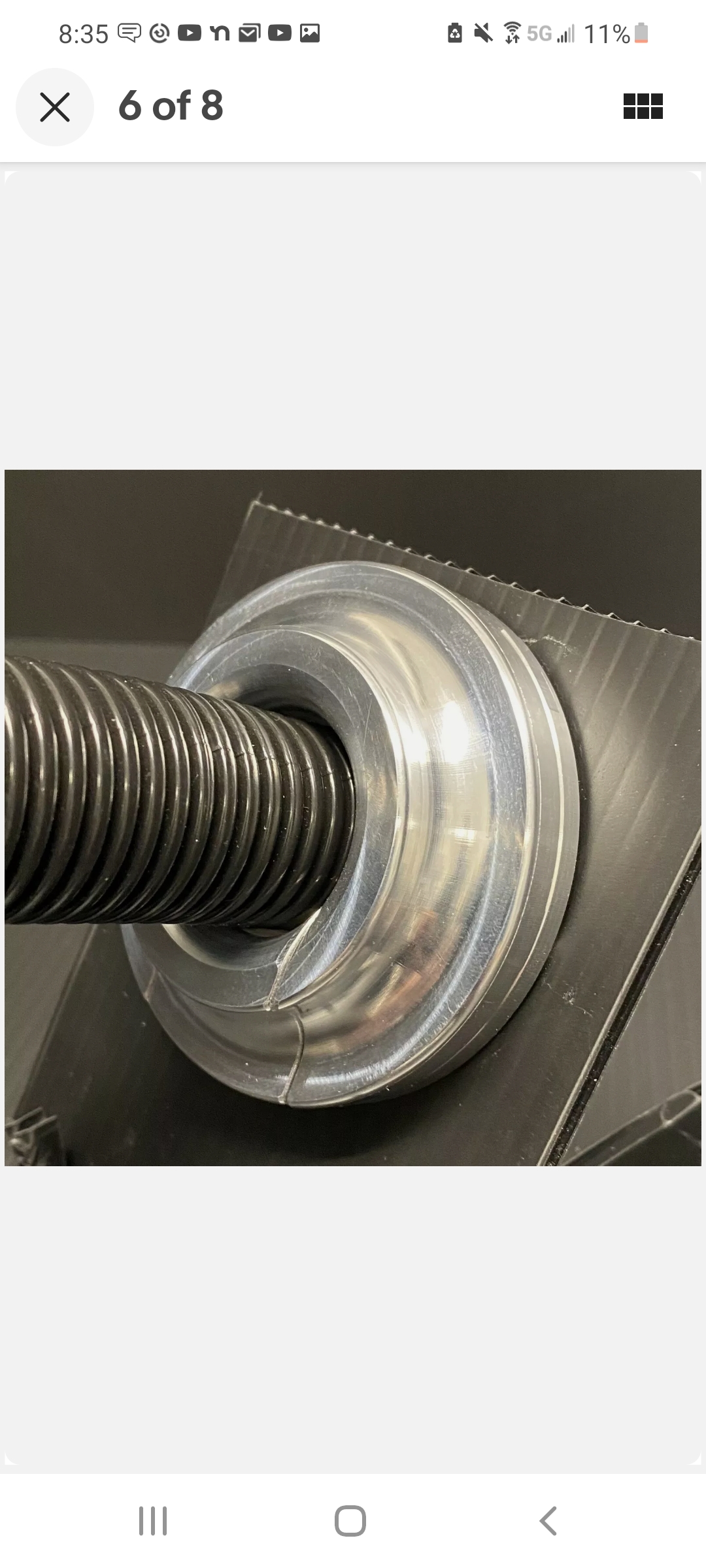

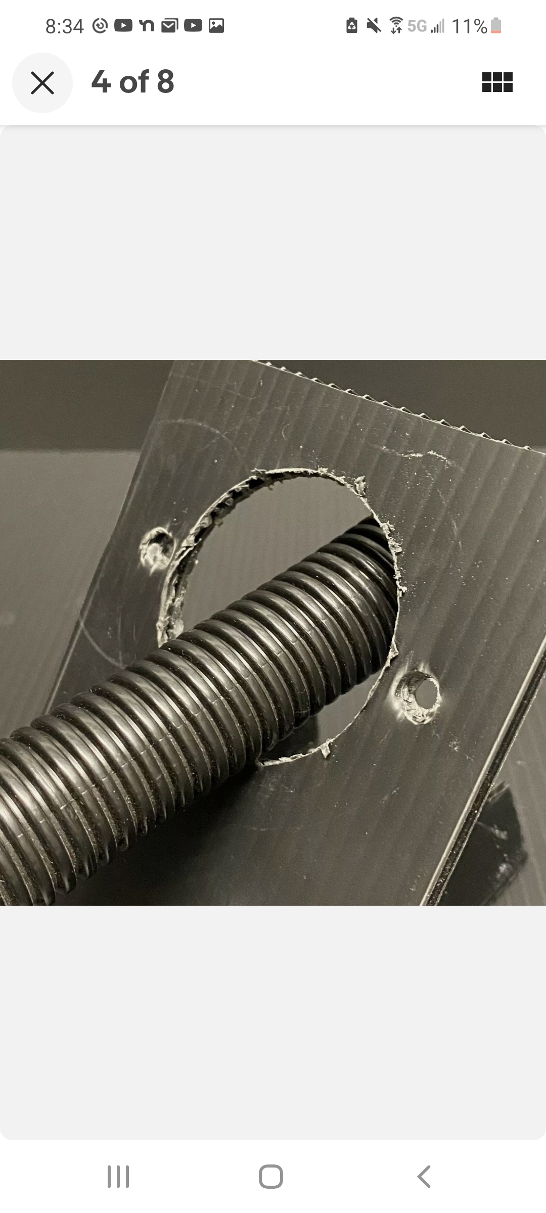

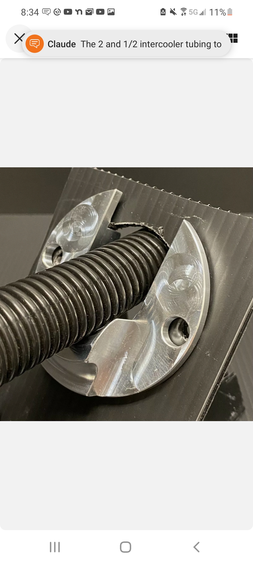

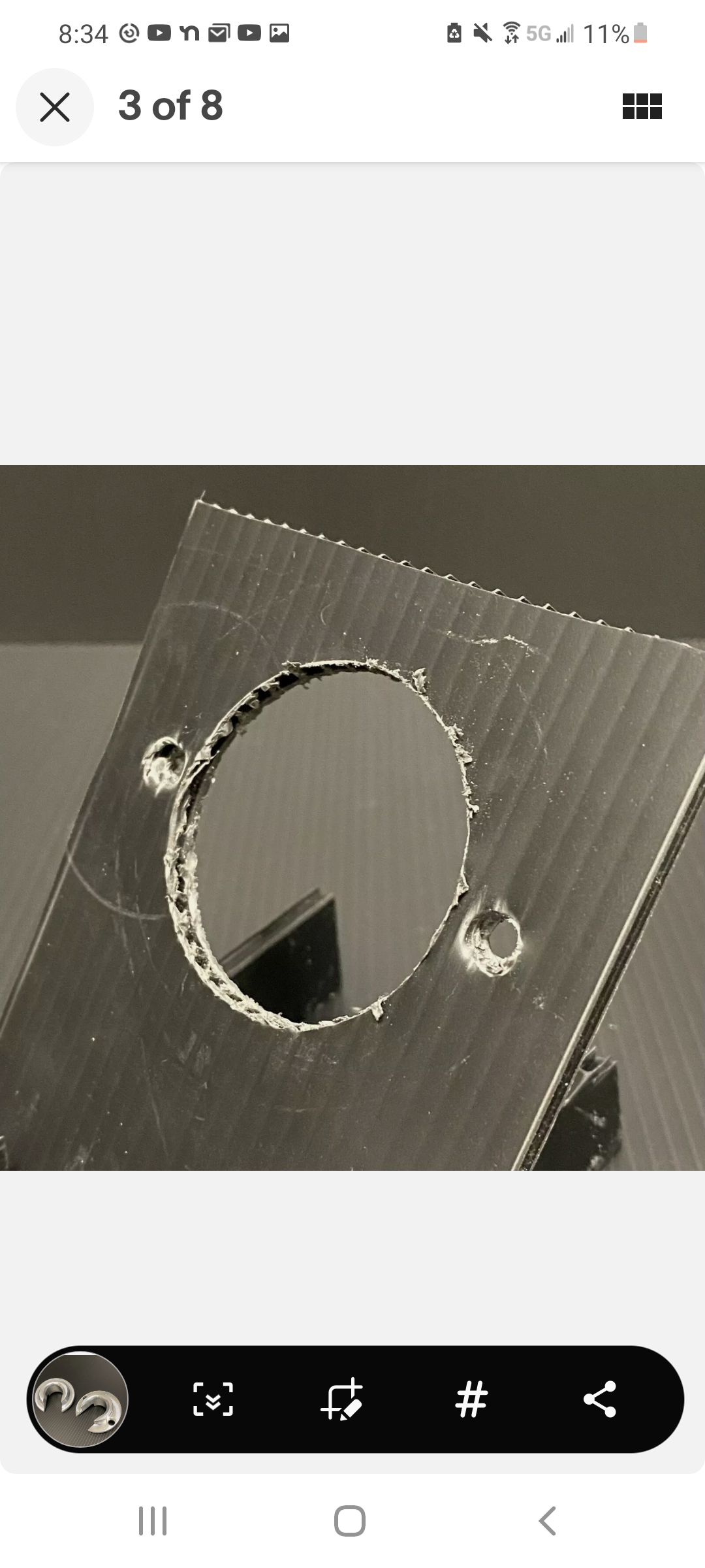

You drill a 2" hole in your firewall, 2 holes for the mounting screws. Mount the firewall pass through on the engine side around the harness, have a buddy tighten the the nuts on the inside of the car and your done.

Ohh so its just the 2 bolts, no sandwich plate on the backside to keep help pull the firewall flat if its not on a perfectly flat spot. The thinner passthroughs have more bolts and conform to the firewall, my concern is the 2 bolts may not suck it perfectly tight to the firewall. That would be remedied with a 1/8" backing ring with the 2 bolts. I can easily fab that up. I'll consider picking one of these up. Thank you!

I hope these images help
