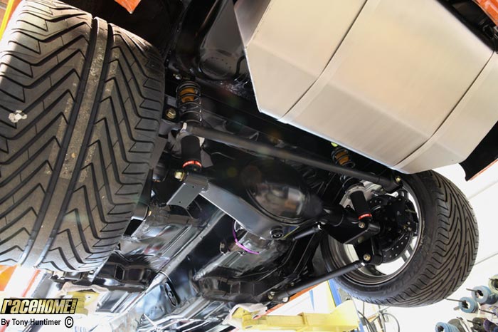

I have this setup. If you are also running a DSE quadralink Rick's has a custom tank that will make exhaust routing easier. I have this one. I simply asked for the same tank being used on Camaro X and FUel.
-Tracy
Here is a picture..

Do you have any shots of it with the car on the ground? I'm trying to see how it looks from behind. I just want to make sure that it doesn't hang down too low below the tail pan. Also, are the 45's that are cut to clear the shocks on a quadralink set up?

Nevermind...I just checked out your photos and found what I was looking for. Nice ride!

The 45's are specifically to route the exhaust without such a sharp bend at the shocks.
