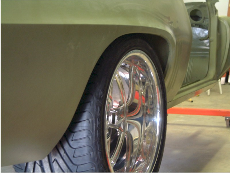

I just finished mini tubing my 69 with the DSE kit and I have exactly the same size rims. I have 18x12 Budniks with 5.5bs and everything fit. I ended up with about 3/4 clearance all the way around. I also just got a new Moser rearend, which I ordered 55 1/4 wheel to wheel and it fit prefect. The car is still not together, but I have mocked everything up. I also trimmed my wheel well lips a little to give me a little more room. I attached a couple of pictures showing the mockup.
