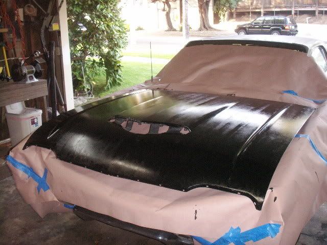

End of the day and I have to say that I have a new found respect for Paint & Body! I thought I would start on the hood and see how it turns out. I guess I'm going to have to spring for a buffer! I bought enough supplies to paint the whole car but a quart of the paint is probably more than enough to paint one car! Total cost for materials and equipment:
Ryobi Orbital Sander - $77.23
Sandpaper for Orbital Sander - $6.79
Rustoleum Professional Black/1 Gal. - $36.18
4" Hot Dog Rollers(5 pack) and Applicator/ w Hot Dog Roller on it- $8.59
Mini paint pans(3) - $3.73
Wet Dry Sandpaper Packs 320/400/600 - $9.89
Tack Cloth(2 packs) - $1.98
Total(So far)- $144.39
Got all the clearcoat off and smoothed and feathered any raised or low areas as best I could!
Masked, Taped and Tacked! Ready for paint! I didn't prime it since the original thread said primer was not necessary!
1st Coat
Many people have commented on what they felt was the ideal Paint to Mineral Spirits ratio. As I was mixing it seems that a 70% Paint/30% Mineral Spirits is a good mix. I guess we'll see but I'm glad I went a little heavier on the paint since the hood of my car has many contours and if I would have mixed it any thinner it would have run all over the place. I guess the best way to describe the mix I did was to make it a little thicker than milk. I was also worried about whatever excess paint I had would dry up along with having to constantly be cleaning the roller so I just used ziploc bags to keep them moist!
Next up.......color sanding.......Oh Goodie!!!
John

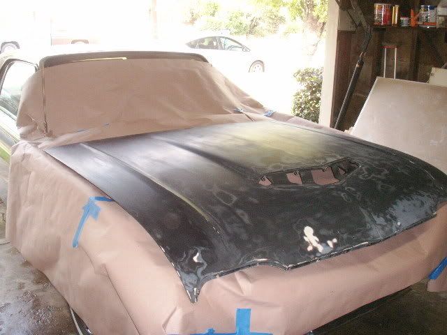

i do not think you are gonna want to color sand that, i doubt it will work like the article said.
Why do you say that?
John
Old 06-11-2007, 08:55 AM
68protouring454's Avatar
68protouring454 68protouring454 is offline
Posts: 1,593
for one there is no hardner in the paint, 2- all the different levels from feathering out will more then likely burn thru, then you will be re doing it. if your gonna roll it out, roll it out and call it a day. its just gonna make more work for yourself
goodluck
Old 06-11-2007, 09:09 AM
novanutcase's Avatar
novanutcase novanutcase is offline
Join Date: Feb 2006
Location: SoCal
Posts: 1,435
So you think it's better to roll out all the coats then sand? Don't sand in between?
BTW I checked it this morning and it's pretty hard. I tried the fingernail test and the paint won't scratch off!
John
