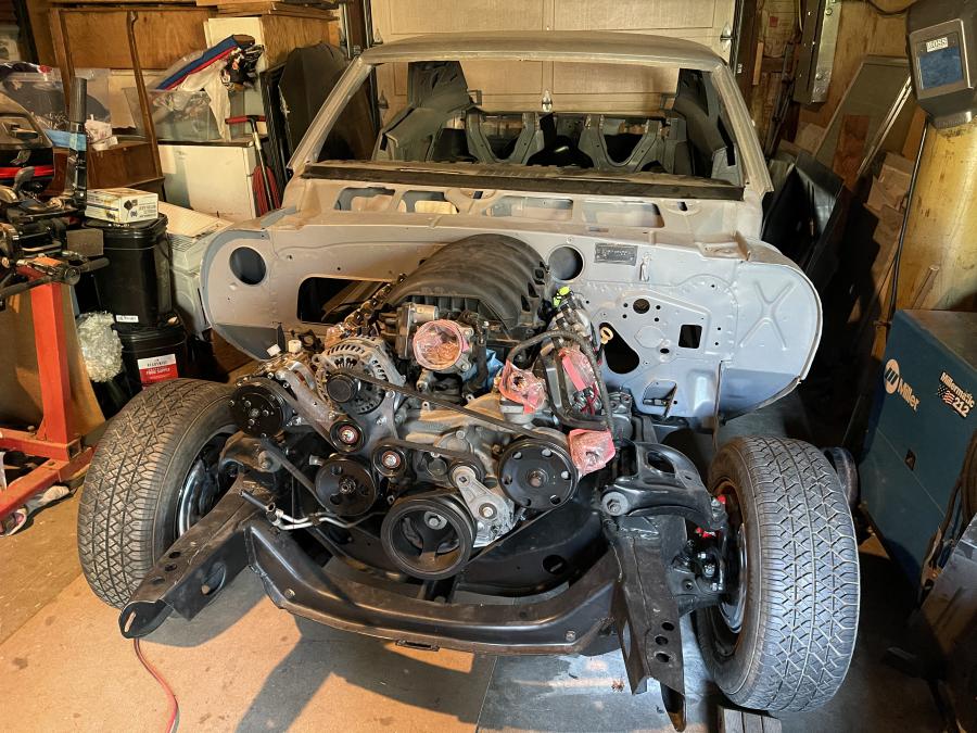

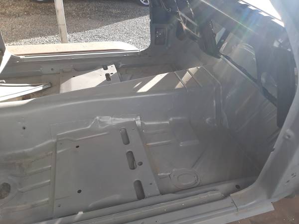

Hey. Ryan in the Bay Area California. I picked up a 67 Camaro freshly media blasted and epoxy primered. All the sheet metal looks really good with the exception of the driver quarter panel and trunk area. I have reproduction steel for those areas and will be doing that along with a mini tub kit since the car is all apart anyway.
Going with an L86 8L90. I did a test fit with the drivetrain and everything fits great, so onward with the sheet metal.

Progress

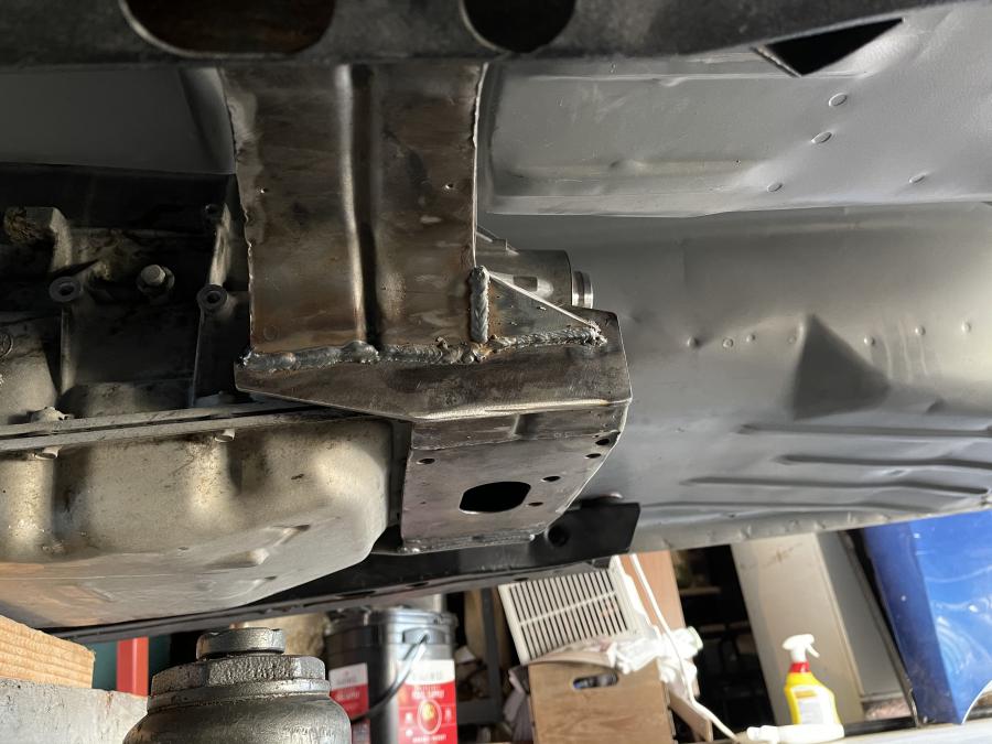

Drivetrain

The 8L90e fit the tunnel with no mods? Do you know what the driveline angle is? I would thin with factory frame, engine sits high, and the tunnel being factory / 8l90e being big, it'd have to be down a bit.
Looks like an excellent start to this project and looking forward to updates

Angle seems ok when comparing it to the subframe. The motor does sit a little high but when I tried to drop it down with the 69 Camaro/Nova engine stands it wouldn’t line up. The trans fits the tunnel I think due to the engine being 1.75” forward from the stock engine to trans area.
