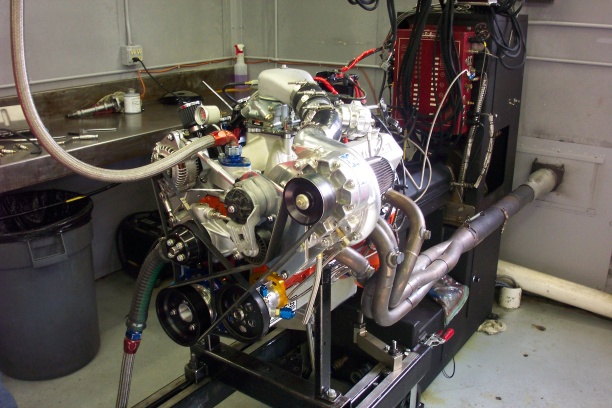

Just returned from the dyno with 'mixed' results... Pulled some good numbers on the motor alone, without the blower belt. Put the belt on and that is where the troubles began...
all motor = 560HP/448TQ @ 7,000 rpm with 30 deg timing.
motor with blower = 640HP/515TQ @ 7,000 rpm with 28 deg timing.
Seems the regulator was NOT boost referencing with the blower. It actually was DROPPING significantly as the boost increased. We ran out of time for the day and are home doing our homework to figure out the regulator. We are going to hit it again in the morning. With the 560 on motor, we're hoping for 700+ with the blower.
Attached is a pic with the blower. Video is coming soon. Once I figure this damn camera out!!! Stay tuned...

Sorry Scott, no 700 HP.... the cam is just a bit off on lobe seperation. The best we could do is 645hp/550ft-lbs @ 7,000 rpm with the blower. A you can see from the dyno screen shot the HP curve just kept on climbing, wanting more RPM as went along. I wanted to spin it higher with the max impellar speed (50K) but thought better of it for now... We're going to put in the car as is and maybe do a cam swap this winter and go for 700HP when we have good air.
