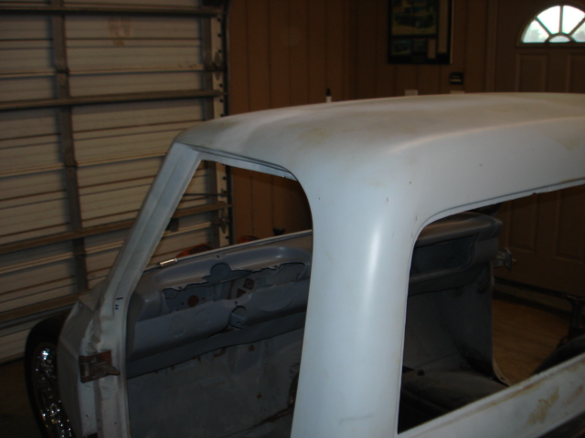

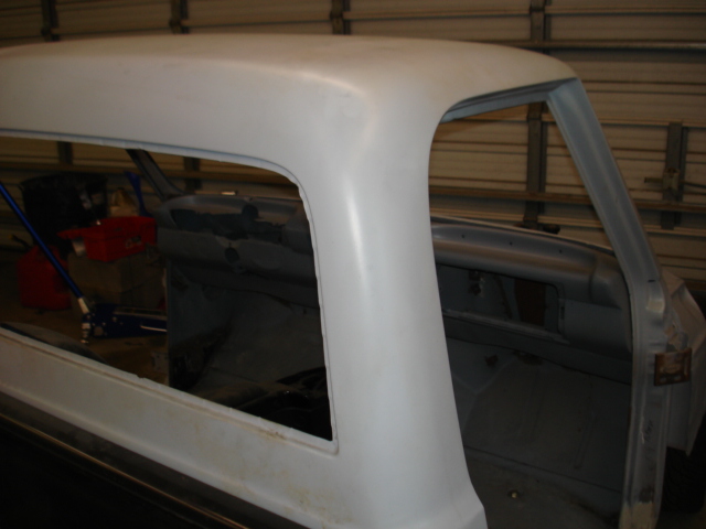

ok craig first 2 are my stock 68--last 3 are of my p.t.68 in progress!! hope fesler doesn't notice the '59 impala dash (lol) he may make me one out of billet!!

all the work was done on the cab to match the doors!! (make sure weather strips are temporarily in place--really changes the door profile on these trucks)
that is why i pulled in the windshield posts -- the are 1/4 inch out on these trucks from factory --when u shave drips , the door flushes on top of frame and back edge but stills hides behind windshield post!! looks like crap to me--stared at it a week before deciding to cut--really easy on these trucks--still time consuming-- Frank is right about the small rod--does give nice look and strength!!! jim

Posts: 474
Craig let me add 1 thing- the doors were fitted and after hours of jam alignment and i was satisfied then began the drip removal!! the cab is still not a dead match to the door frames top and back but then the massaging comes in with lots more hours--i will send more pics in a few weeks when i reinstall doors and u can judge for yourself if it was worth it!!! look at the stock 68 pic from front and u can see how much door sits tucked in behind windshield post!! jim
