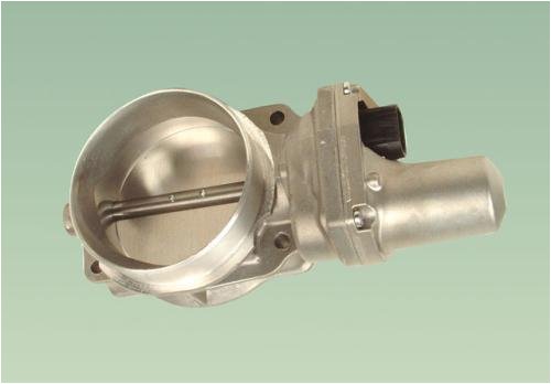

what computer are you going to use? That will determine if you need throttle by wire or not, they're set up one way or the other, not both.
The throttle by wire tb's have no cable hookup or throttle arm on them at all; they have a round cylindrical motor that opens and closes the blade.
Looks like this:

The mystery of dbw is becoming more simple all the time.
I have come to prefer it. No cable through the firewall - no cable to adjust - cleaner engine bay - and NO idle screw or set adjusments. You can run a way lumpy cam with a more steady idle - built in cruise control...and more.
you need what they call the 0411 PCM, then get the gas pedal and TAC module from the donor truck.
There are several throttle bodies you can use - but you need to make sure they match the bolt pattern on the intake - some are three and some (the later LS2 and up) are four.
Your harness will depend on the reluctor in your crank (24 or 58) and if you want to get dbw or cable. If dbw, you need to know the complete application to match the pedal, tac and throttle body.
