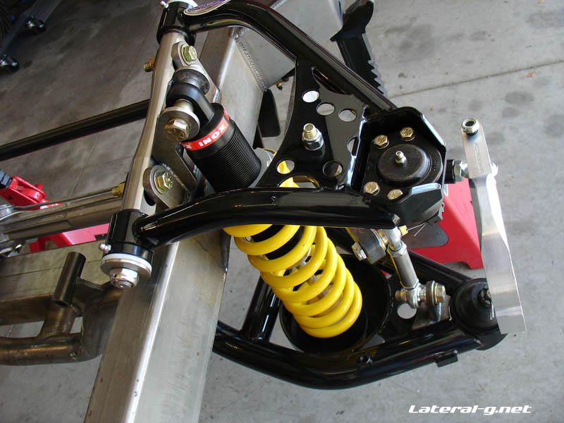

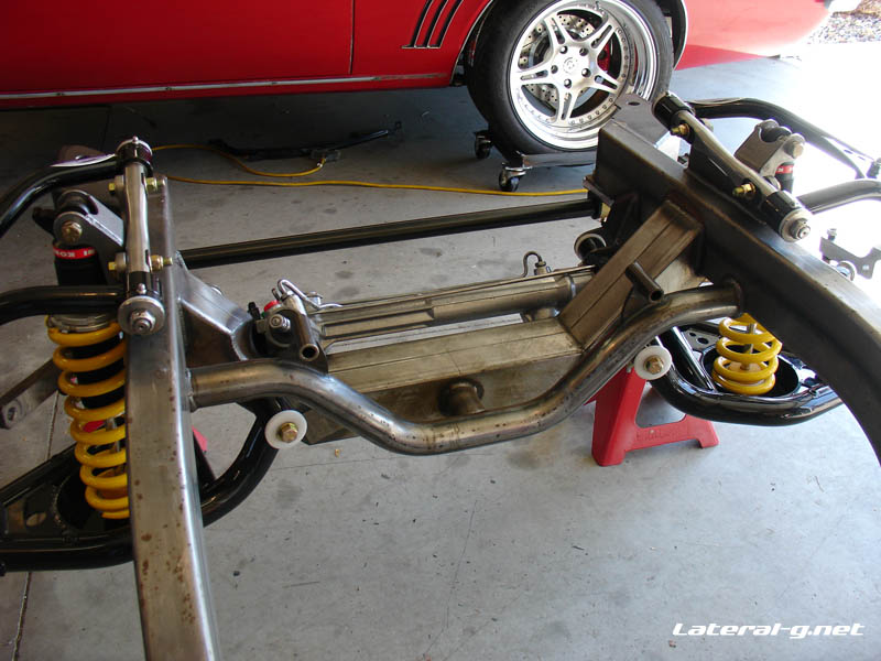

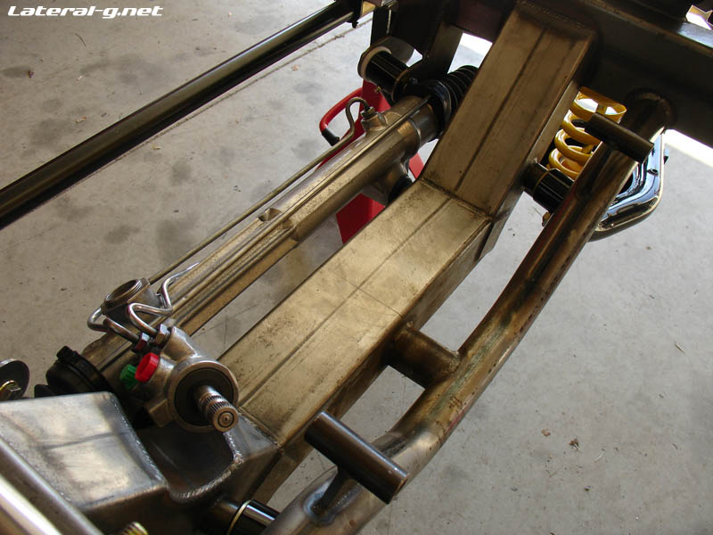

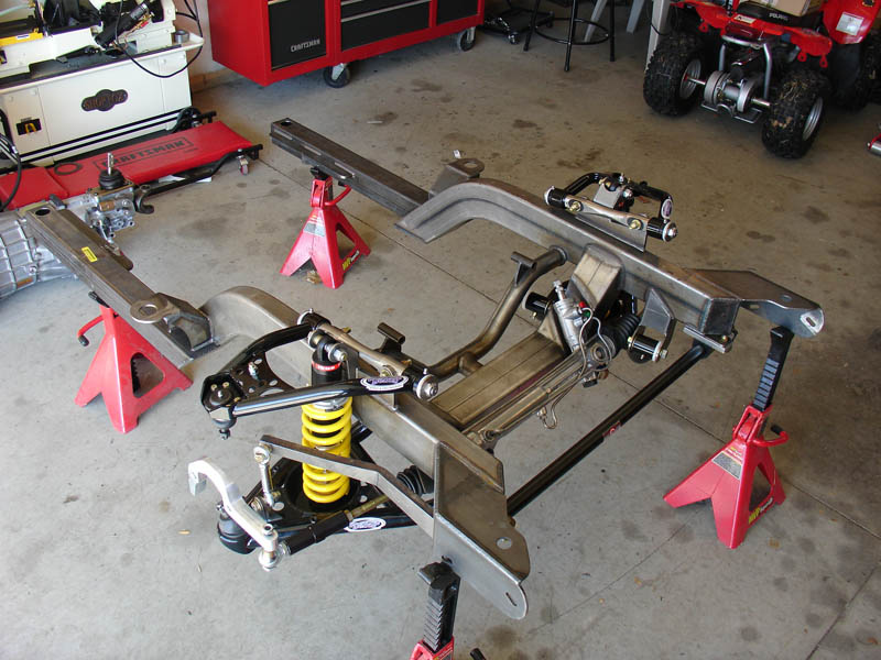

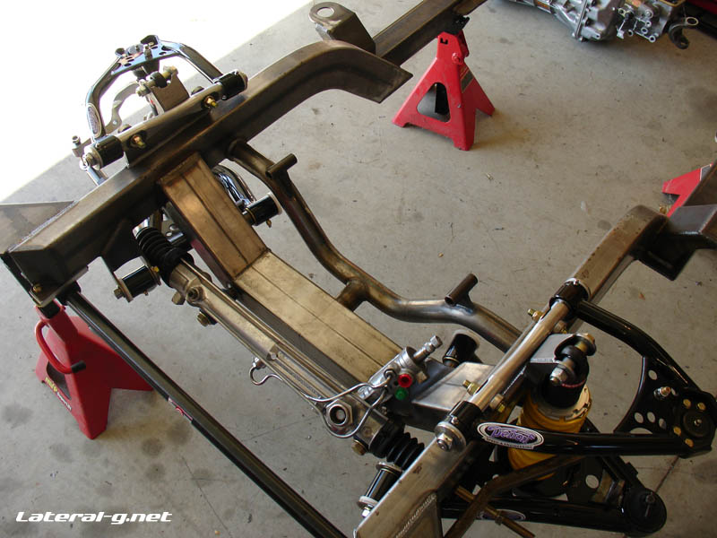

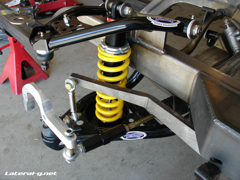

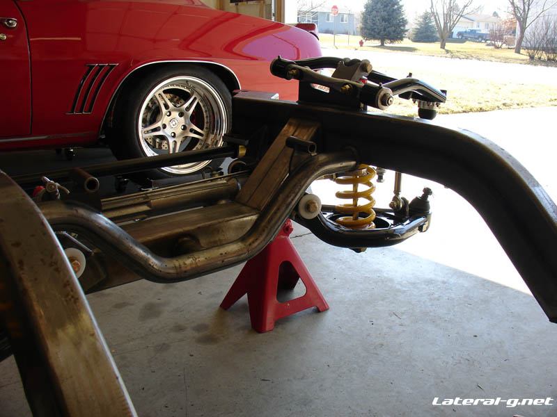

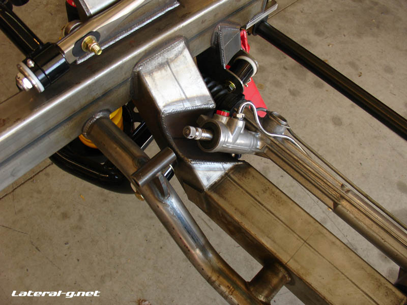

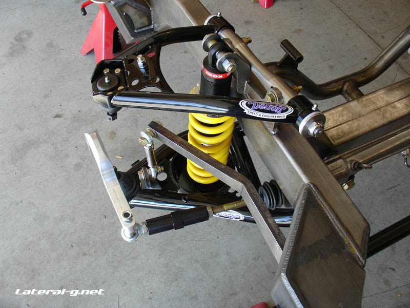

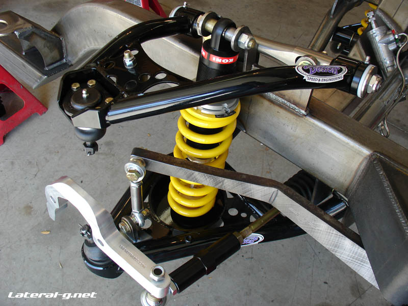

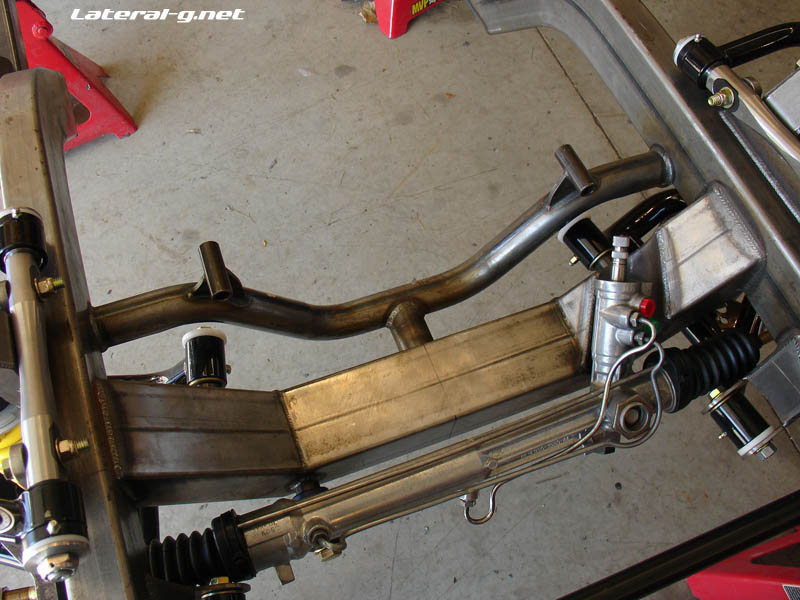

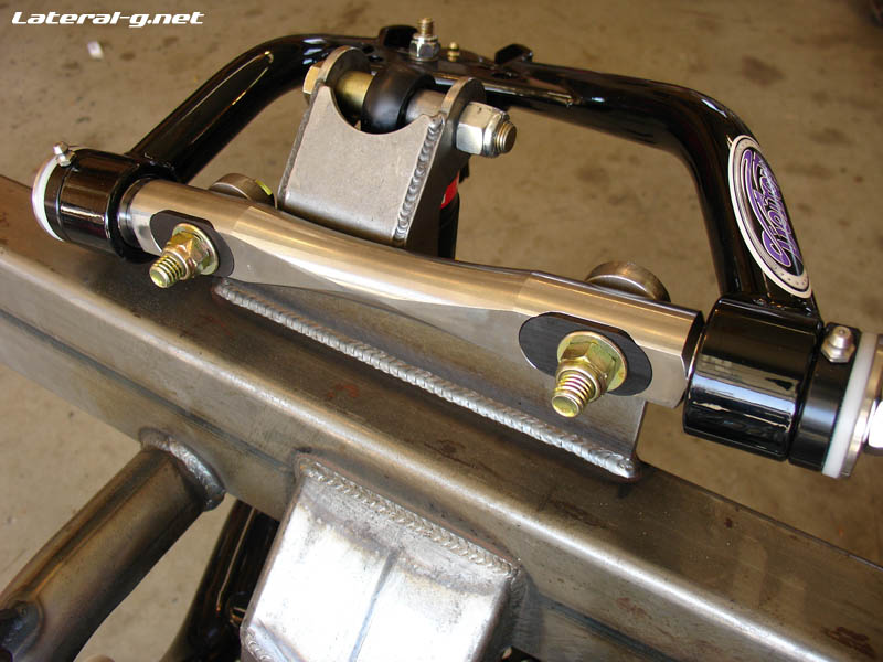

Here's my NEW subframe that just arrived from Wayne Due. It uses DSE control arms and their coil over assembly. It has an AGR power rack with Baer trackers and Phil Brewer billet steering arms. The sway bar is from Speedway Engineering. It uses the stock spindle.
What's slick about this setup is if you already own aftermarket tubular arms, big wheels and brakes for a 1st Gen, those parts will bolt on to this all new Wayne Due subframe. It will also allow 10" wheels to be used and the track width is stock.
Since this is new from Wayne and I expect there to be a lot of interest, I'll post a BUNCH of pics.

Very nice Scott I see the community T-56 back there

Default Are those true coil overs?
I can't tell from the picture, but are those true coil overs or is the bottom of the spring sitting in the a frame? Could a shock wave air shock be installed?
Old 03-21-2006, 09:46 AM
ProStreet R/T ProStreet R/T is offline
Join Date: Oct 2005
Location: SoCal
Posts: 181
Those look like 100% koni coil overs to me.
It appears as though the shockwaves would fit, the only concern I would have is with the clearance around the swaybar endlinks.
Yes. They're the same ones you get from Marquez or DSE.
