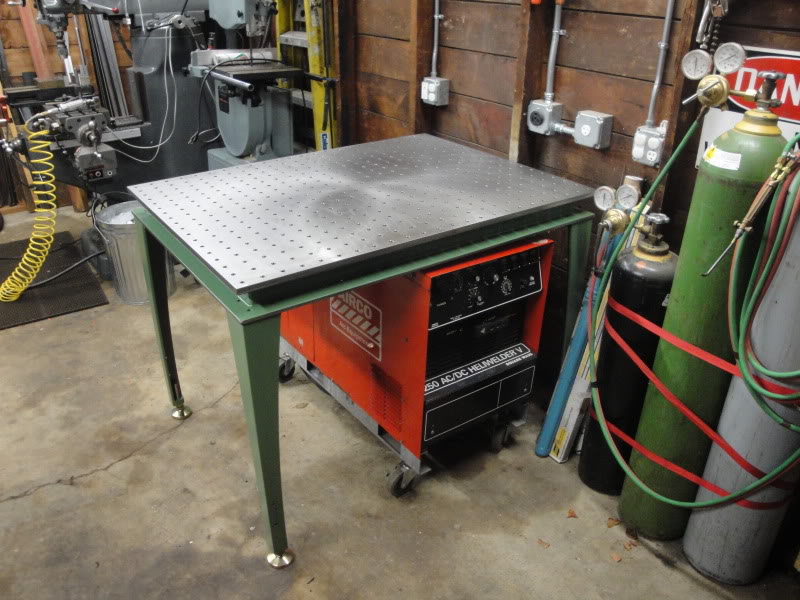

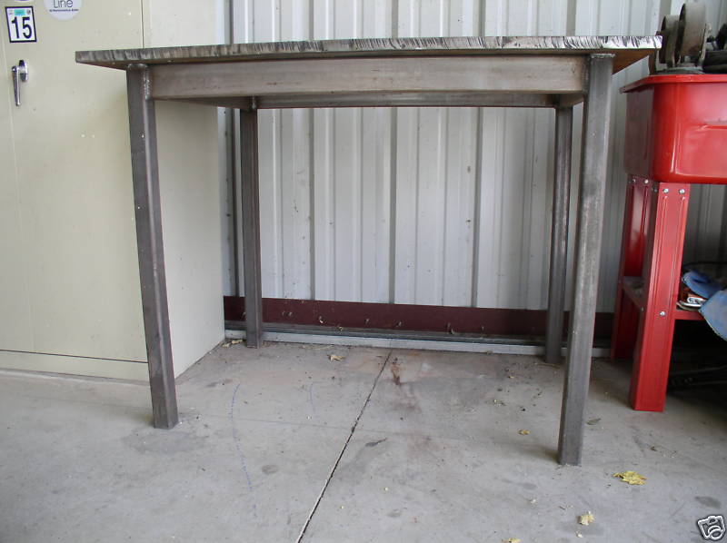

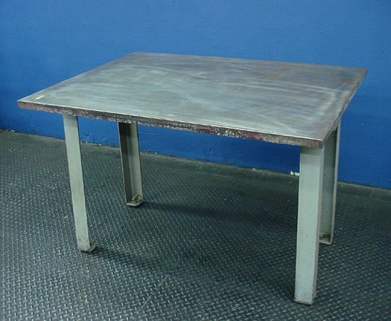

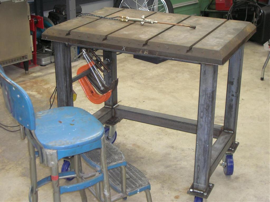

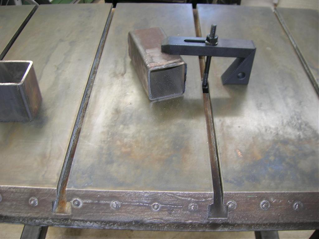

Over Christmas and New Years I started thinking about a welding table design that I could build. I searched the web for pics and ideas and found some interesting ideas. Just wondering if anyone here that uses a table often has some additional ideas or preferences they might like to add. Post your pics, ideas and comments !
I'm looking to build a 36 x 36 with a 1/2 thick top. 4 square legs (2 or 2.5) with levelers. Square or round tube cross supports.
C clamp and Vise Grip hangar rail(s) on the left side.
I plan to have a hole grid pattern waterjet'd on the top so I can thread the holes to mount hold-down jigs, tooling and clamps.
I liked the ability to bolt down accessories (vise, grinder, hanger dolly stand, etc) to the table with a standard size mounting plate. Maybe even a shelf under the table to place the accessories out of the way while not used.
Hangers/holders on the right side (I'm correct handed) for the torch to hang and welding pliers, etc.
Electrical main cable with a couple outlets.
Miller even has a 12 x 12 opening in their top that allows installation of a torch/plasma cutoff area and includes replaceable cross bars. There is a removable catch tray under that area to dump the junk.
Basically a smaller table for a garage dog that provides lots of versatility needed in a home hobby shop.
Here's some pics of the nicer one's I've seen.

I personally love the first blue leg with big azz Wilton (the ONLY vise to own) design... I like the kick-out for the vise.. and it has power down a leg and the top is killer and the leg design is sturdy without being ridiculous. I never have an opinion either...
When looking at some of the others - there are a couple that are all top and no legs - and one that is all legs and no top... and one that looks like swiss cheese... letting everything fall thru that can... and if you welded to it - the threads will get bunged up... ditto if you hammer on it... and you need to be able to pound on a table like this. You try dragging or schunching (a made up word) a rear end or heavy part on a table like that - the holes will scratch it or hang it up - and the part will damage the threads...
I don't like a "back" on a table like this... it will, at some point, interfere with what you're working on... you need to be able to move pieces in all directions - and they have to be able to hang over in all directions.
