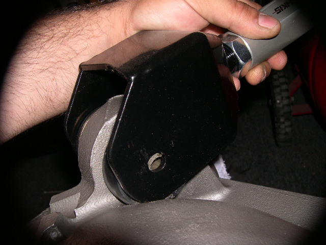

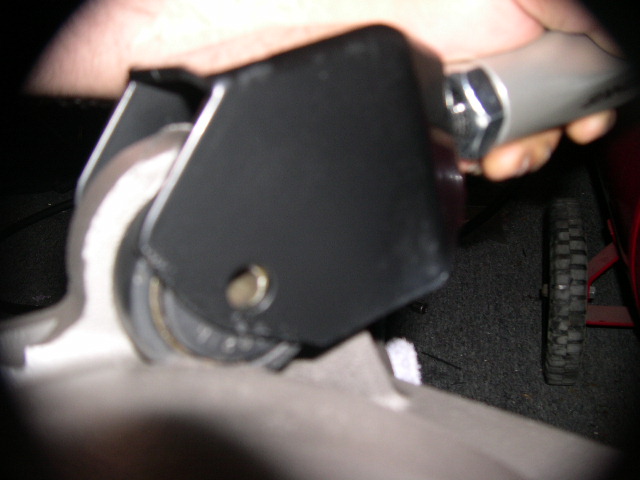

I`m in the process of doing the installation when i noticed on the upper control arm specifically the drivers side i had to put a notch in it cause it would not fit due to it hitting the rear end housing,has anyone experienced this problem with their`s on their GM A-Body?

Something ain't right, take a picture and post it!

Here are 2 pics,1 is before i notched it.

what size is that rear end? 10 bolt,12 bolt? that may be the problem
Its a `67 Chevelle 12 Bolt rear.
Thanks
I wonder if hotckis sent you a 10 bolt arm,the 12 bolt should be angled were it mounts to the ears of the diff
I dont know dude,maybe i`ll call them tomorrow and see what i can come up with??
