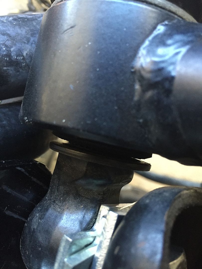

On the upper control arms, all 4 of these move very easily and freely around. Should they and what is their purpose?
I'm referring to the inner small washer seen in the above pic.

Have you tightened down the cross shaft nuts all of the way? I can't really tell in the picture you posted but the washers will be loose until those nuts are tight.

I'll have to double check that. I thought I tightened them up tight, but not too tight so that there would be bind. I just may have them a little too loose.

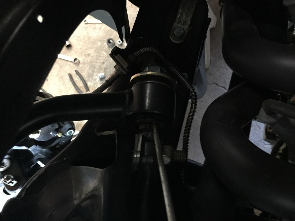

Here's another pic I uploaded a while back. I'm suspecting the arms are too loose.

No torque spec given but:
5. Tighten cross shaft nuts enough to create a drag on the delrin bushings, the arm should still move.
What I am seeing is tighten the nut @ ride height till the slack is taken up on the washer. 1/4 turn past. Retest.

Thanks Vince. In my #5, the instructions aren't worded like that. All I have is 'Position the suspension at mid travel and tighten the cross shaft nuts.'
I was so worried about bind, I did not tighten these enough. All 4 inner washers move freely and easily quite a bit. This is hopefully the source of the loose clunky feeling I have. I'll have to double check the rear as well.
