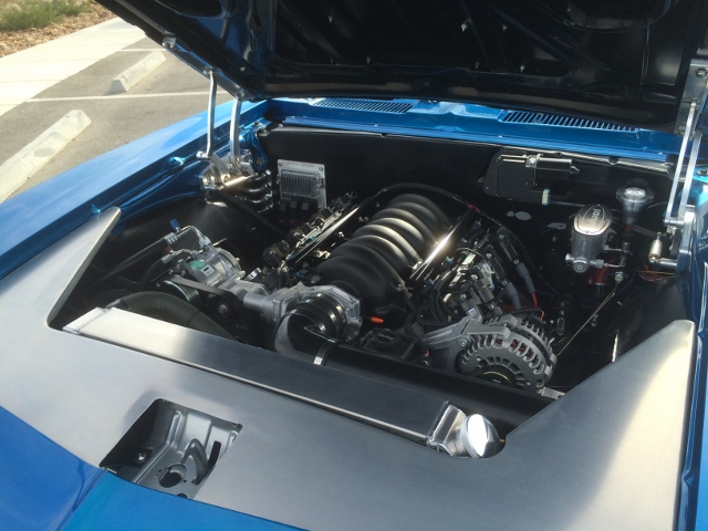

or Like I did on my new car with Holley Fuel Rails.
Ran fuel line on driver side and remote battery cable on pass side
