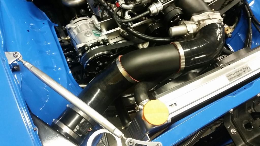

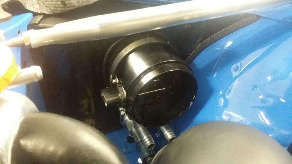

Built my own custom closeout / air box on the Pass side, and the entire filter is inside the fender

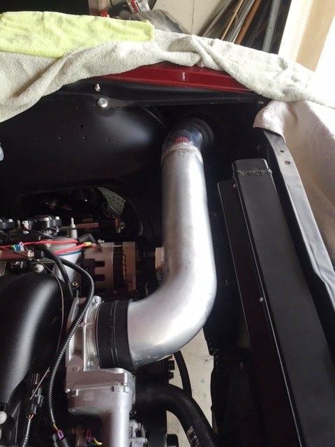

I got a Spectre driver side kit, They are redesigning it so they sent me their first new one which I welded up for a cleaner look.
