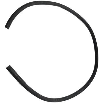

Dayco 87616 Hose
5/8 Hose belled on one end to 3/4"
I cut the 6" 3/4" part down to about 1 1/2"

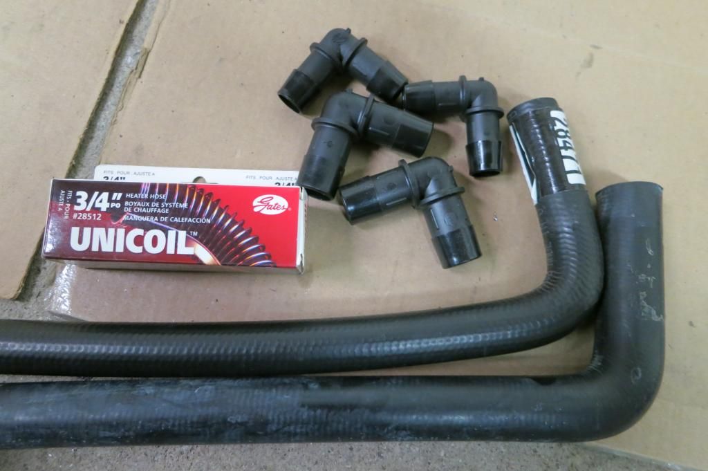

I used the hoses pictured here. Not the plastic elbows. I'll try and dig up both part numbers.
