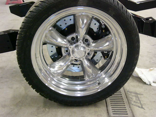

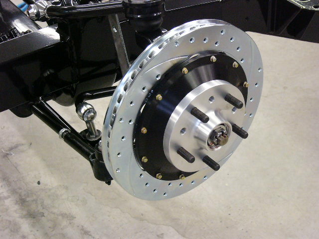

Yes – they will work! I did have 13” Wilwoods upfront w/ 17” Torque Thrust wheels. Below are some pics. I have since switched to 14” brakes and 18” wheels.
Hope this helps,
Mark
