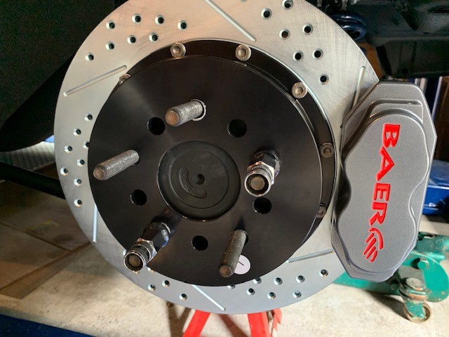

So my baer rotor won't fit over the moser axle register. has anyone opened the rotor center hole before? gonna find a machine shop to do this for me. but just wanted to see if anyone had run into this issue before.

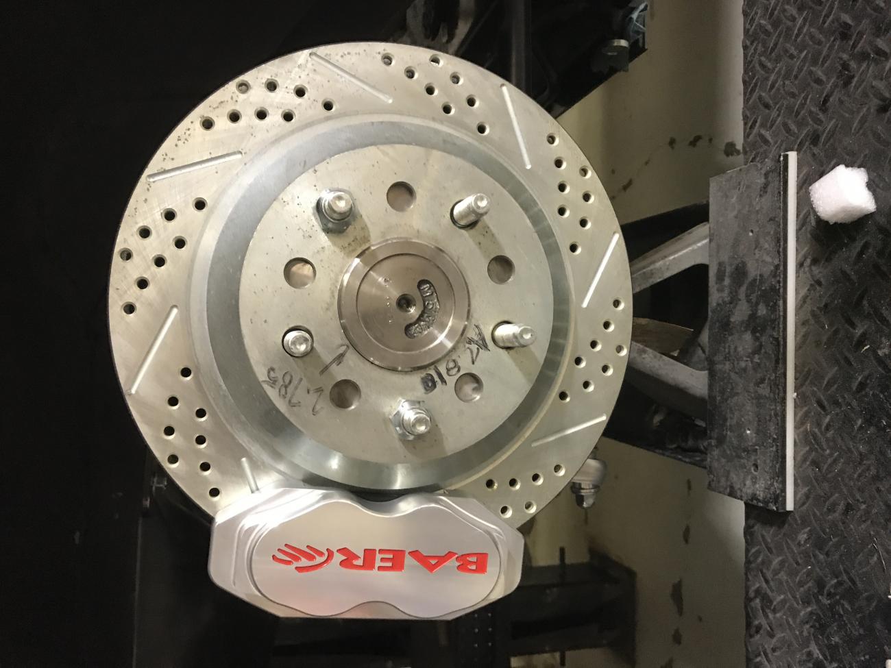

Yes, I had to open the hole for my Moser axles. I also had some issues with the park brake drum inside the rotor that I had to fix. Different rotor than yours, single piece but it came from Baer with the SS4 rear kit.

Thanks guys Looks like it was built for willwood rear brakes when it should have been Baer. So I may open the rotor up to the 3.060 hub. just want to check with baer that it will not affect the hub at all.
