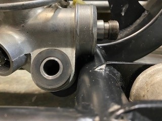

I have offset bushing for the 16" center. My problem is the mounting tabs on the frame are to low, and the rack hits the side rails before it reaches the mounting position. I also purchased a 82-88 Mustang II rack from Speedway that didn't fit.
