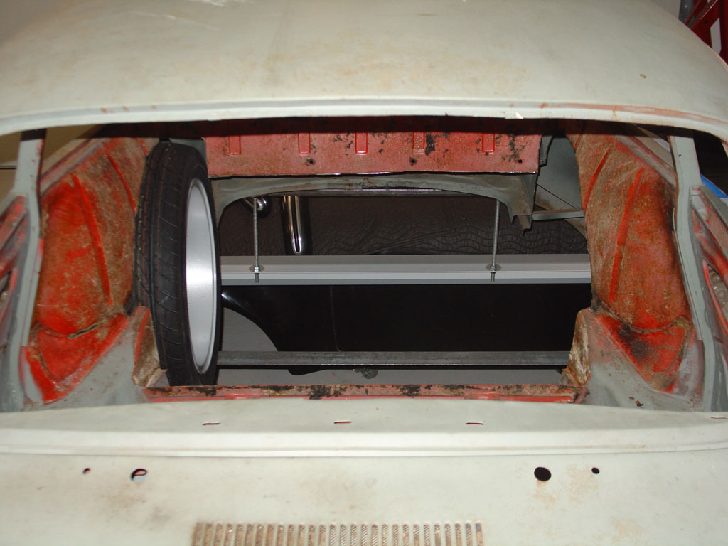

Tonights progress - Part 1,
Installed some bracing to hold up the rear end while I cut away the frame structure - found it FULL of sand from sand blasting that had migrated in through the bolt holes and drains. Finished cutting out the trunk and rear seat floor.

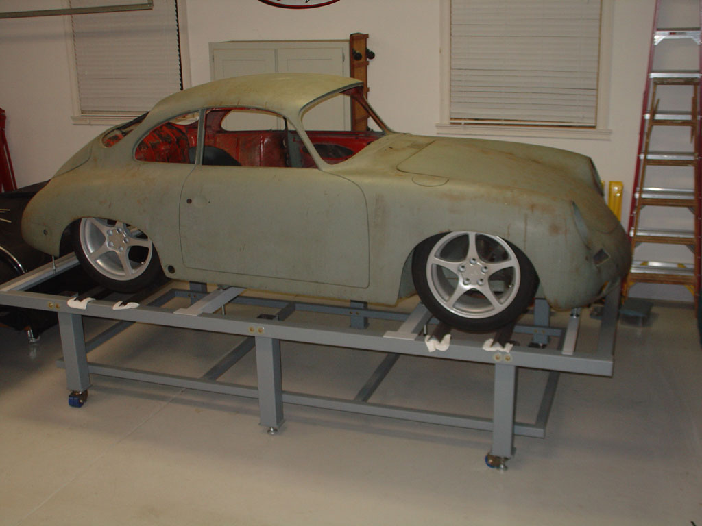

Progress Part 2,
Set the rear tires in. Set the ride height at F = 5.75 and R = 6.5. I think the rear should go up more - so I can set the pax window ledge level ? (I can lower the rocker panel down easily if needed) Here's everyone's chance to provide feedback.
Any critiques, comments, ideas or guidance from anyone is always appreciated - and I don't take it personal - so feel free to call it like you see it. Thanks !!

They look fine to me. What a cool car this is gonna be! I've always had a thing for that era of Porsche. They just have a really slick and clean look, great proportions, no nonsense and I certainly can't fault your choice in driveline.
I don't think this car will look right with a lot of rake, every line on it slopes down towards the back. I'd keep the rocker parallel to the ground or slightly up in the back since the sloping bodylines create an optical illusion that the rear is sagging.
I never realized there's a bulge just below the trunk that squares the profile off in the back a little. Is there a functional reason for that...rear engine clearance? I dunno.

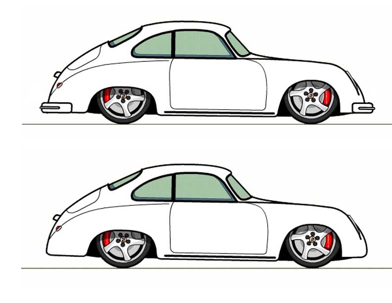

The bulge is there from the alternator on the back of a flat 4 engine - it sticks way back from the engine. I thought about dropping the bumpers on the car last night before taking picture because the bumpers eliminate the bulge quite a bit from the line when installed. (Check page 1 of the thread for the effect with the bumper installed) I've seen these cars with the bumper removed and you're right - the bulge catches the eye down the back of the car - so I left them on but eliminated the 'bumperettes' (the chrome extensions). I felt the bumpers also added 'weight' to the bottom of the car line making it appear to be lower then it really is - or maybe that's just me.

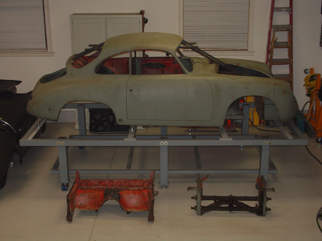

Disappointed with my progress this weekend, Didn't get much done ... had to work Saturday. Installed 10 expanding cross braces. 1.5 (14 gage) square outer tube with a 1.25 (11 gage) inner tube. Outer tubes split in the middle - and welded to the chassis at both ends - and welded on either side of the middle split. Installed 4 inside the car (2 floor w 2 roof), 1 in the trunk, 2 in the front, 2 on the bottom at the axel centerlines.

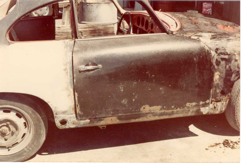

Just some background on the car I thought might be fun to share. 2 owner vehicle and I have all the documentation right down to the oil changes and light bulb replacements - he even measured and recorded the brake pad wear when he replaced them. Attached the original invoice from 65. 2nd owner purchased the car in 1980 for $700 - and sent it in to a 356 shop in Florida for $8500 worth of metal replacement, sand blasting and primer. Shop labor rate was $22/hour - try that one in 2007 dollars ! (Looks pretty rough in the pics) Went into storage in 81 - until 2001 when I bought it.
This week I'll install the stabilizing bracing to tie the top/bottom and front/back of both sides so it won't twist when separated. Then I need to cut out the front suspension, cowl vent, front and rear lock receivers, and the wiper motor mount. Then I can FINALLY split it. Any ideas, guidance or comments you guys have, feel free to pass them along - never split a car before

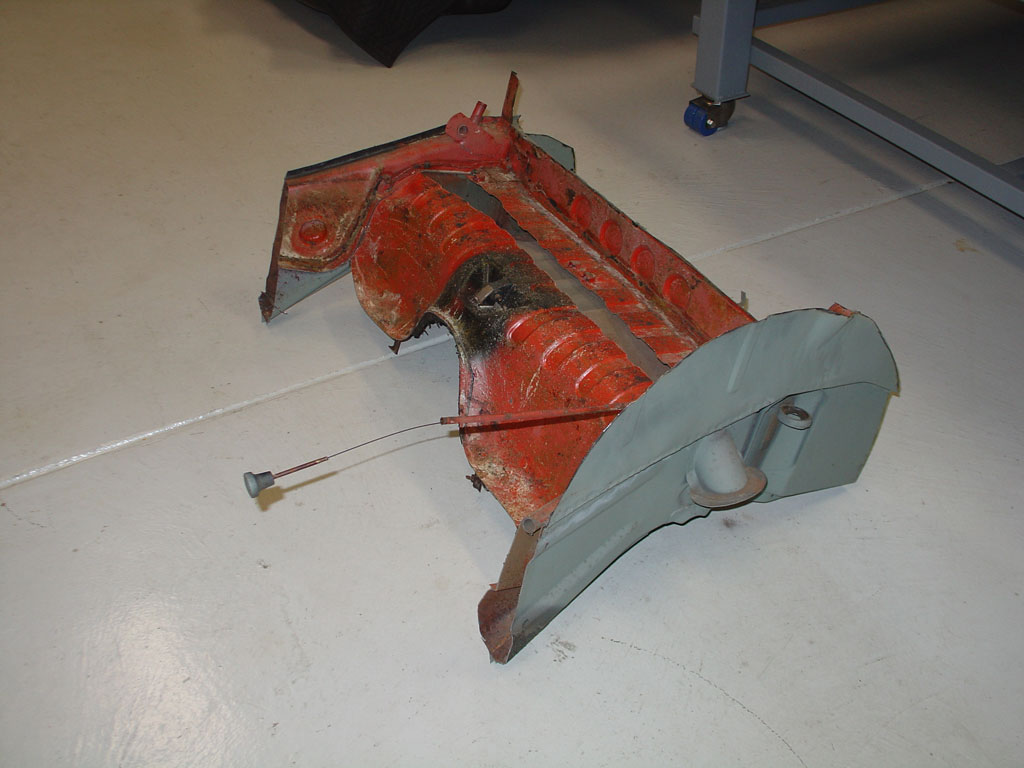

Made a little progress tonight.
Welded in some more body supports. Removed the cowl vent and the front suspension supports. It's amazing how much sand was trapped inside all the core supports and bracing - and that they didn't power wash the front suspension before or after blasting it. the rest of the car is nice and clean - yet the front suspension box was pretty rusted.
