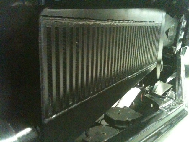

Default Intercoolers
I thought I would share this with you forced induction guys.
When I was in the building stage of this car I took a short cut and went with a cheap ebay intercooler. While trouble shooting on why the car was down on power I discovered there was a 15psi DP across the intercooler due to the air flowing across a long narrow path of core creating the high DP. Bell designed me a intercooler that would allow the air to flow across a wide short core, which lowered the DP across the intercooler and allowed the car to put 835 HP to the tires a 125HP gain by swapping intercoolers. The ebay intercooler was a nice piece for the money it just wasn't a good design for what I had in mind. I hope this makes sense and keeps someone from making the same mistake I made.

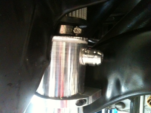

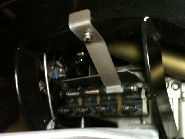

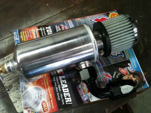

Default Crank case evac system
In order to keep oil mist from entering the combustion chamber and causing detonation I decided to install a new evac system. I went with 2 of the new re-designed Moroso breather tanks. The tanks now have an internal baffle with a stainless mesh to help separate the oil. I ran a -12 line from each valve cover to a individual tank. I hope the pictures are not to dark.

Interesting info on the intercooler. I'm running the same type of intercooler that you were it looks like. Amazing you picked up 125 hp from swapping.
Mine has a Vortech T-trim with an LS2 bottom end, LS3 heads. Has a mild cam in it but managed to put down 655 rwhp, 550 rwtq. I wonder if the intercooler is holding it back any... Not that it needs much more especially with a stock bottom end...
