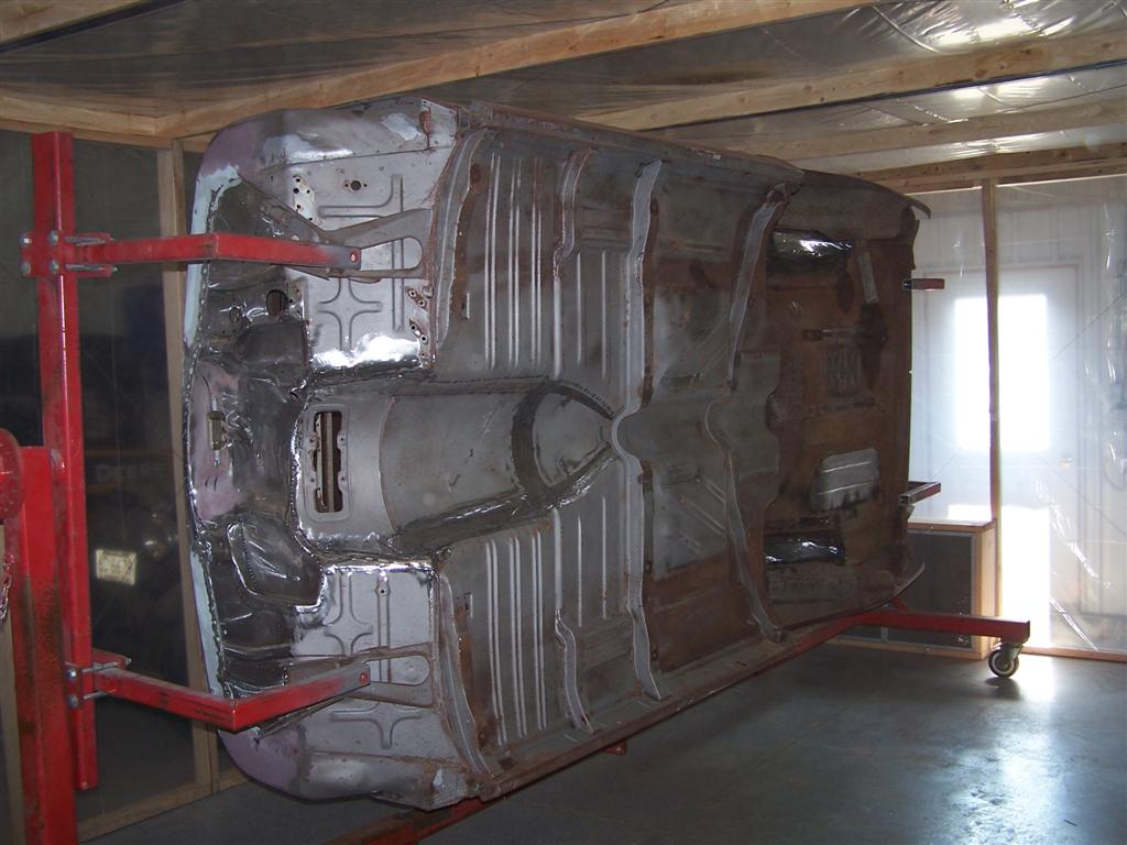

Since the 68 Camaro is in for stitches I've been getting some work done on
"BONER". It's a 56 2dr. on a full AME chassis, 582CI. 745HP. carb. motor.5sp.
trans. Hyd. clutch 9in. Strange diff. 370 gear. Body Mods. will be Subtle on
this project. So far I've--Smoothed and recessed firewall, Raised Trans. tunnel. Extended rockers for a slight channeled affect. Rearranged some
metal on underbody for closer fit to frame. 16in. wide rear tubs. smoothed driprails. Car belongs to Morris Hambly AKA "Slick".He owns a Boneyard so the
cars name is Slick's "BONER". I thought you could use some ShoeBox Cars on
