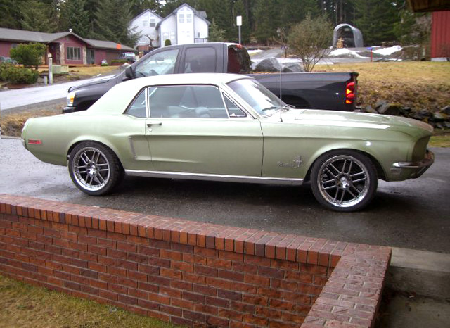

could someone lower the back of my car using photoshop. I'm looking for the car to sit level and get rid of the gap between the tire and fender.
thanks, Brian

Brian,
Hope this helps. In the first image, the back is just lowered. The second image, I lowered the front a little. I also did a little adjustment to make the image a little sharper. Good luck with your project.

That looks awesome. thanks for your help

just curious what size those wheels are

The wheels are TSW catalunya 18x8 with 20mm offset (5.287bs) with a 5/16 inch spacer and 18x9 with 20mm offset (5.75 bs). Tires are 235/40/18 fronts and 265/35/18 rears. I'm in the process of putting on longer wheel studs to accomodate the thicker mounting pad on the front whee.

right now it's stock ride height? or at least close to it? I have a 67 so i figure 68 shouldn't be too different and I have a little tire rub issues on one of the front tires with the fender inner wheel lip. Do you have any clearance issues in the front or back with the deeper back spacing?

The rear is stock height with a 4.5 standard eye leaf and 3/4 in. sway bar. On the front I have 620lb springs that lowered the front an inch with a 1 in. sway bar. All from Grab-a-Trak. There is no rubbing issue with the rear. Infact I could almost go with 6" bs and 9.5" wide wheel. The front clears the upper ball joint by about 1/8th of an inch. Some of the elanore knock offs are around a 4.75" bs. on the front. hope this helps
