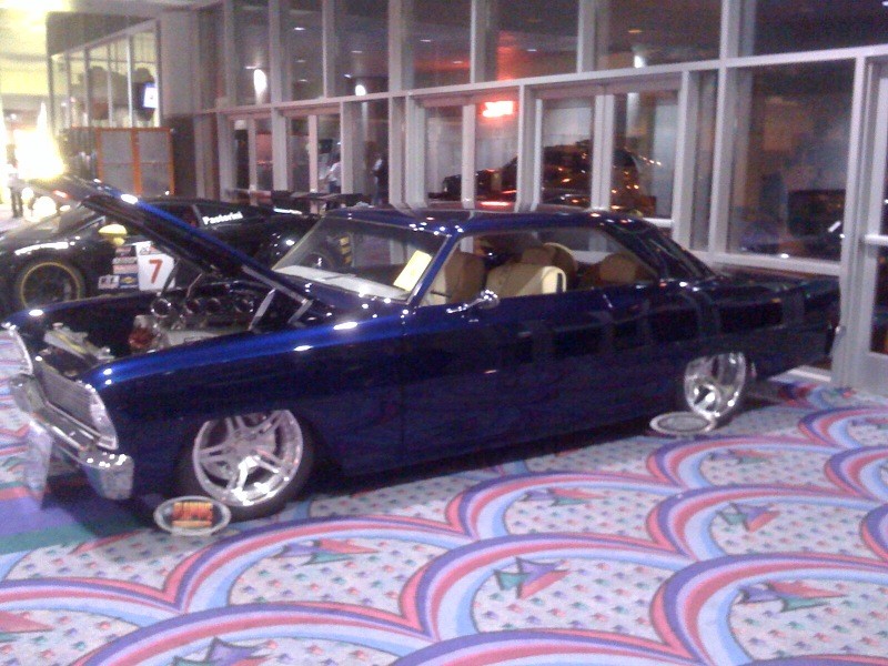

My name is Steve Schalk I live in Oregon City, Oregon which is just south of Portland, Oregon. I am working on a 1966 Nova Chevy II which started life as a 6 cylinder Super Sport. The car will be done and ready for the 2009 Good Guys event in Des Moines Iowa and Columbus Ohio.
I have performed almost all of the work on this car in my garage. I think I have touched or modified every part on this car.

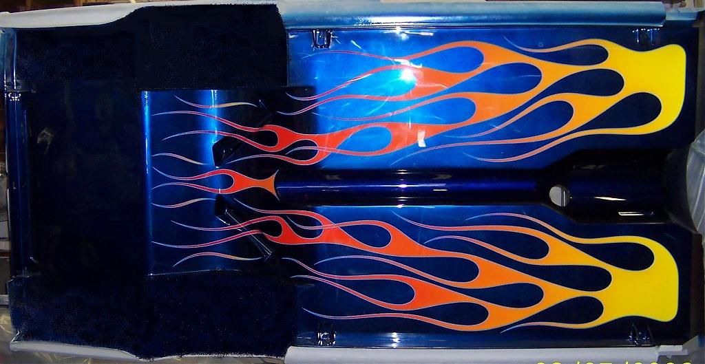

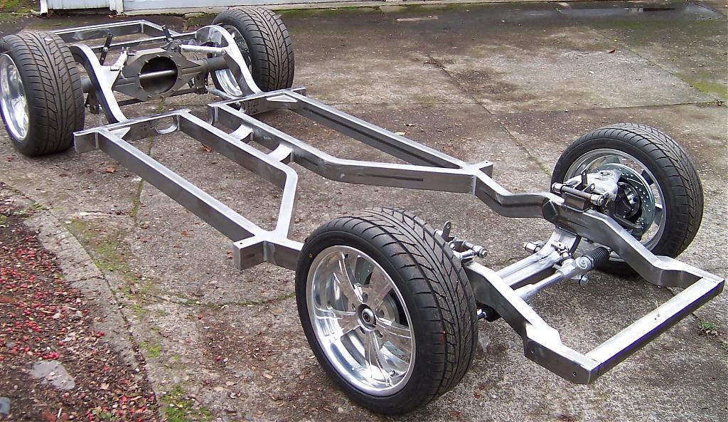

Some highlights of the car: the car sits on a one off chassis that I designed and built using Art Morrison components. The body is one piece, top has been chopped 1", all seams in doors, hood, trunk and body have been removed. The hood started life as a reproduction cowl hood which I took apart and modified, I put a Nova peak in the hood and modified the air box, cowl induction venting and hood latch areas. The windshield wipers and cowl area metal has been replaced with a smoothed version. The doors have shaved handles, gas filler has been removed and the trunk panel inset area has been removed. I have replaced all the interior sheet metal from the firewall to the trunk with 14 guage steel.

Killer car I love those year Novas can't wait to see it in person-Chris

amazing car cant wait to see it finished .... that chassis is killer!!!!!!
