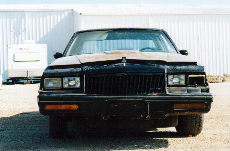

so here it is.

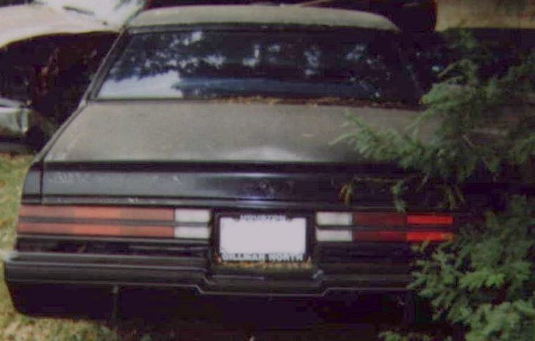

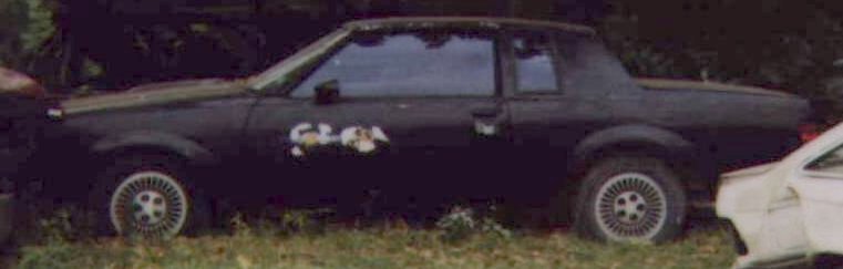

this car was a theft recovery and ended up on his land sometime around 1990. i could only guess the date because the tags on the car had expired around then.
the thieves had stolen the car somewhere in san antonio and stripped its rare lear siegler leather seating and some other turbo car related interior pieces.
they also had seemed to hit a curb with the passenger front wheel, it was missing and the tie rod looked like a pretzel
there was also (to my surprise) an ant mound growing up into the trunk. you cant see it but i got about 30 ant bites for this picture, so you're gonna check it out

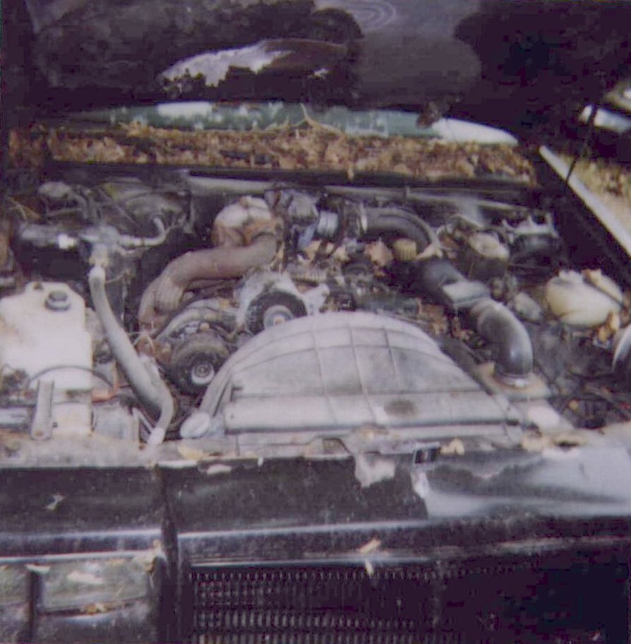

once we got the hood open i found some more goodies
all stock, except if you look closely you can see the familiar K&N warning sticker on the airbox. there were remnants of nests in here, lots of droppings and chewed wires, about 8 years of decaying vegetation as well.

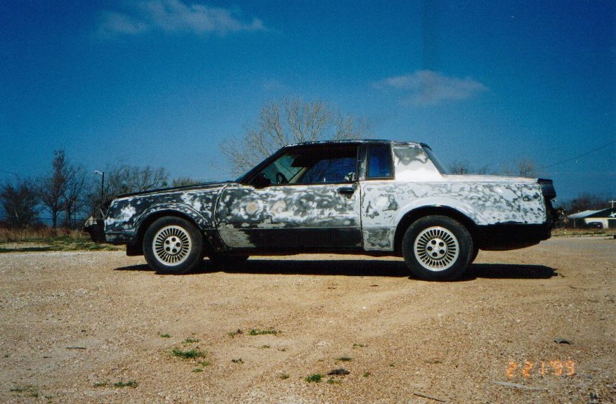

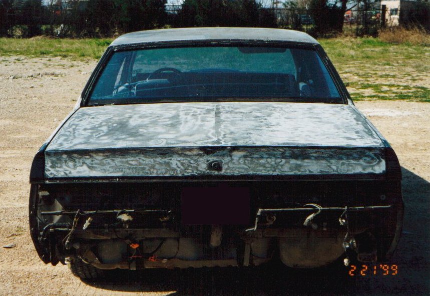

at this point we took it back to terrell to my uncle's bodyshop and i got to work sanding the car down to bare metal so we could start fresh. i was doing this in the winter in an unheated shop and quickly learned that DA sanders and fingers dont get a long too well.
it took awhile but eventually i had the car pretty adequately stripped, some in progress shots.
it looks so sad, haha.. thanks to gnttype and turbobuick, i had gotten the car running pretty well at this point, it was able to annihilate those old tires on the rear without issue.
the only thing out of my reach at this time (and still today) is body work. my uncle had one of his paint guys do all the prep and shoot the car.

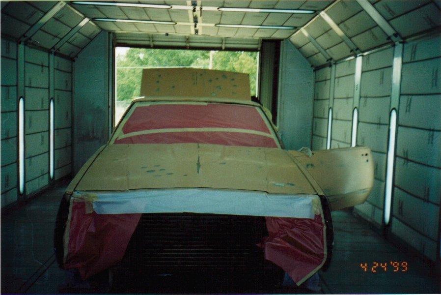

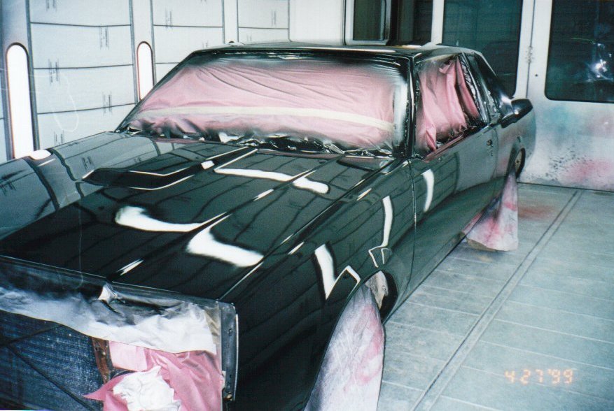

in the booth..
now seeing some of you guys' projects here it is FAR from perfect but for $600 including materials, what are you gonna do? the car was shot with a metallic black found on 1998 honda accords and looks GREAT in sun; the metallic flake is a very fine mixture of red and blue. none of the pics do the actual color justice but hey, this is all about a nice photo laden documentation of progress, right?

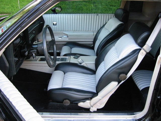

so at this point there is something that needs to be done about the interior. a good friend had some black carpet from ACC that he was ditching in favor of another color, so he gave it to me. free = good
after that i made some calls and found someone that used to work at an upholstery shop that was wanting to do some stuff on the side.....
and $350 later we have it. i reversed the color scheme on the seats to match the later cars but kept the lear siegler seats i purchased from a good friend in alabama instead of using the seats out of the newer cars. i used some VHT interior dye to color the top of the console black as the original "bone" shade had discolored and faded.
now yes, i know the interior plastics and the seats dont match 100%, but its as good as i could do at the time and no one but myself and a few really picky people have ever said anything about it.

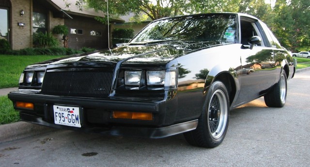

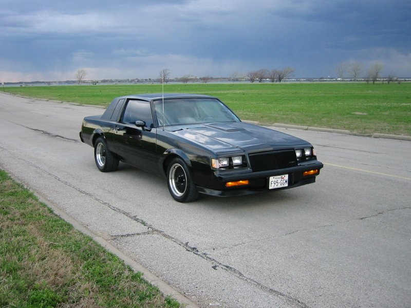

and here we have basically the finished product
before anyone says anything, yes i have one black wheel on the car. i wasnt sure if i liked the gunmetal i finished the wheels in, so i did one gloss black just to experiment.

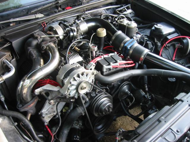

i'm tired of typing for now so i'll leave you guys with a halfway finished shot of the engine bay
