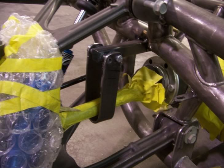

Old 02-26-2011, 06:29 PM
out2kayak out2kayak is offline
Join Date: Feb 2010
Location: Leo, IN
Posts: 440
Thanks: 4
Thanked 18 Times in 17 Posts

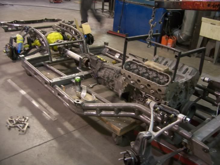

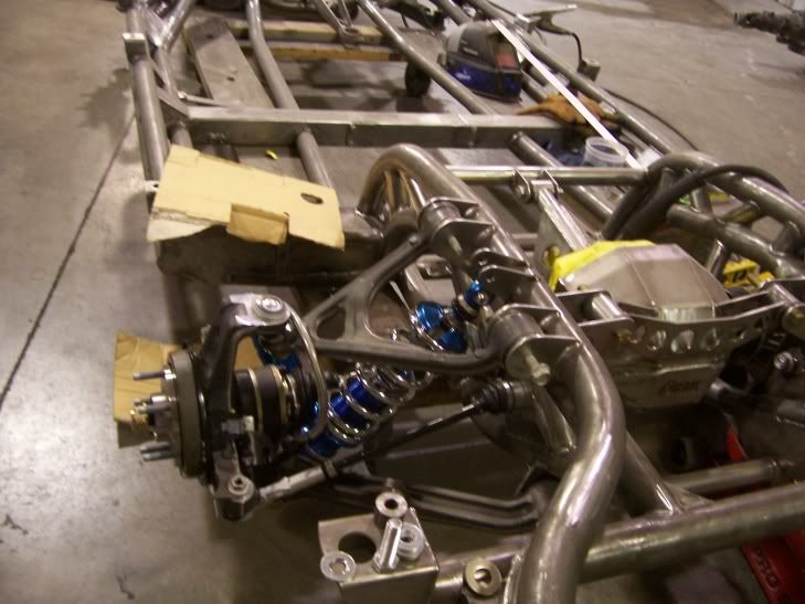

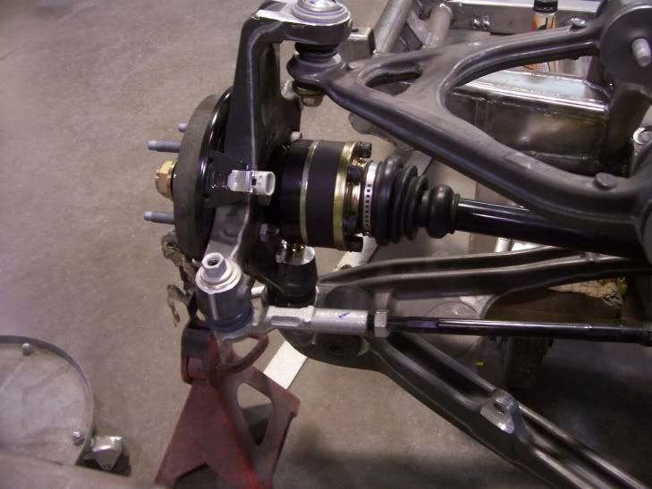

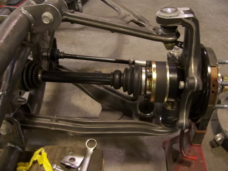

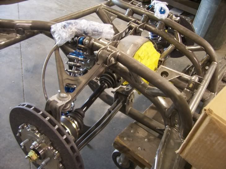

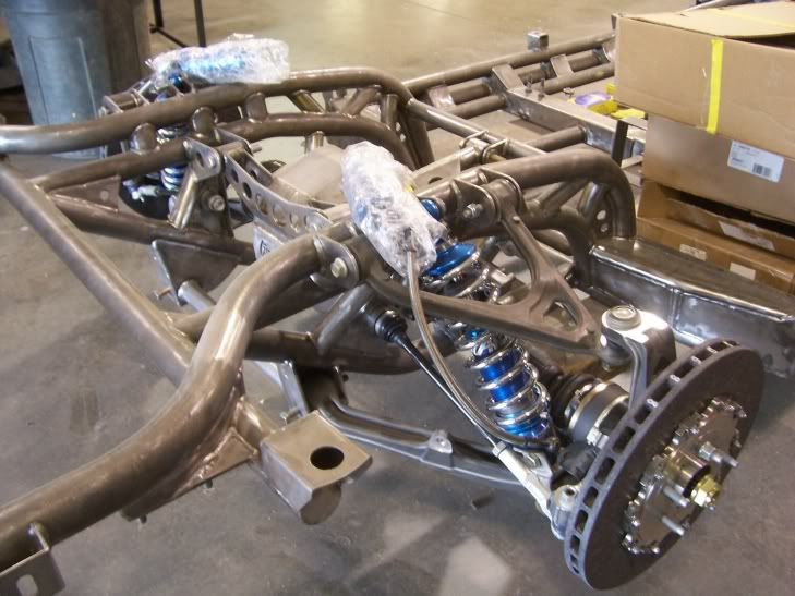

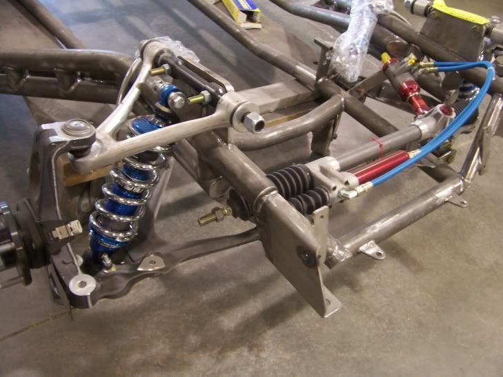

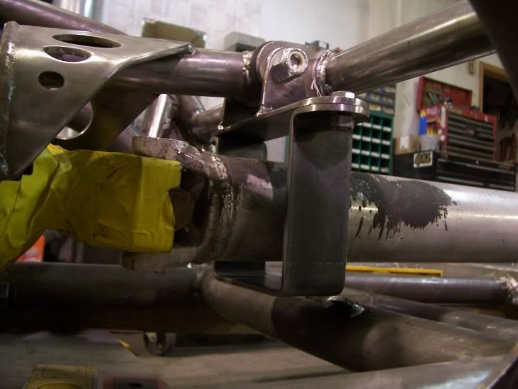

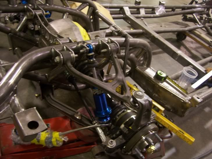

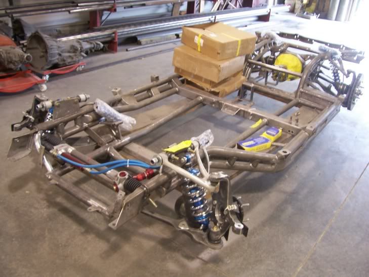

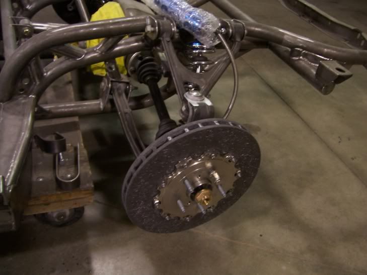

OK, so I have not posted in a while, so here is some pics:

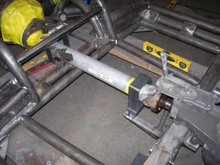

Old 05-07-2011, 06:55 PM
Join Date: Feb 2010
Location: Leo, IN
Posts: 440
Thanks: 4

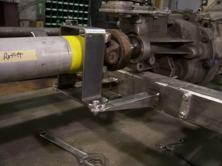

Few more pics:
