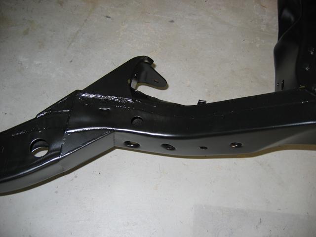

Thanks a lot Jody, your info is helpful. Do you have any pictures of the frame mods Mark did? I didn't remember the chassis being showcased in the PHR article.
here's a few.........

I narrowed the frame on my '66 the same way. But I moved mine in 3" per side instead of 2" like Malitude. Which fit a 20x12 with a 335/30

I just picked up another frame and was looking to move the frame rails in 2-3 inches to fit 18x13 335's on my 69 chevelle. do you have any pic's on the upper support modifications. i have a good idea but wanted to ask in the event i am missing somthing. I also had some concerns about lossing my sway bar. i noticed Malitude still has a rear sway bar, any idea how that was modified to fit the narrowed control arm gap. i am thinking of Hotchkis's extreme sway bar kit may work sinc it does not mount to control arms.
