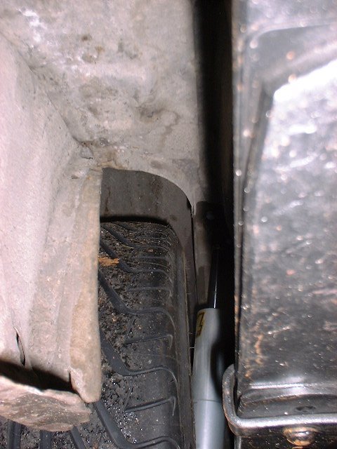

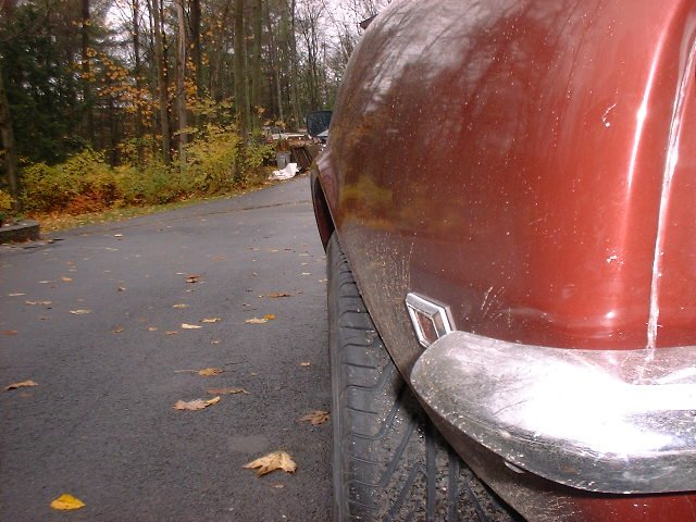

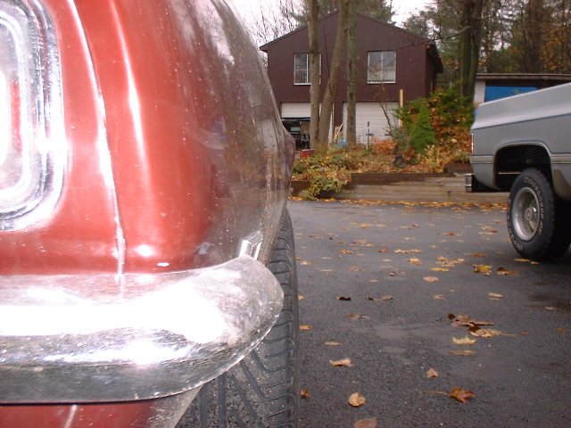

I've got 17x9.5 Intro's on the rear of my 68 (drum rear) with 5.5 BS. The Intro's are actually 10 inches wide from bead to bead do to the fat lip. You shouldn't have any problems.

I have 17x10 w/ 5.75 backspace, was too close to the inner fender well so I'm using an 1/8" spacer on both sides.... 5.5" would've had me trimming/rolling the outer fender. Stock rear, Wilwood 13" disc kit, 285/40/17 Michelin Pilot Sports.
