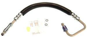

Here is the C5 hose. Note how long it is so that it clears the pulley.
