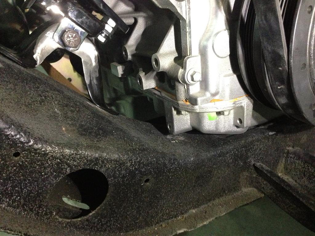

Hello guys
Hope you can give me a direction on this problem. It looks to me like i have the wrong motor mounts, but i dont know for sure how much room i need for the engine. The oil pan looks to hang dangerouse close to the ground. Also the engine sits with just half a inc on the subframe. How much room is it supose to bee here?
Thanks for the help.

What oil pan is that? Doesn't look like an Fbody pan. I would swap to an Autokraft or similar pan and save your self some headaches.

I have this one: http://www.crateenginedepot.com/LS-S...93-P10829.aspx
