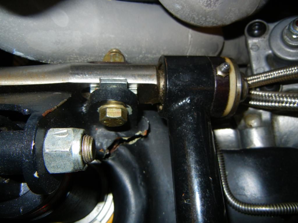

Is that broken paint on your upper control room mount?
The torque will be the best part. We built it for a wide, flat torque curve. I also went for an aluminum flywheel, dropping 18# of rotating weight. It should rev quickly to say the least.

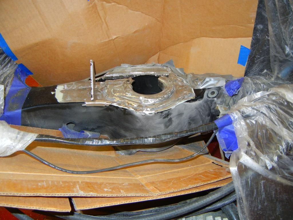

No, that is a broken control arm mount. As in a collapsed front suspension. This should be it's own thread. But since you asked...
There were some cracks in the bondo that I only noticed after I got the car home from the auction. I thought (hoped) they were only cosmetic, but not so.
The first time I drove the car, the front mounts broke from the subframe.
Luckily, the mount bolts tilted into the headers and stopped the movement, saving any sheet metal/ wheel/ or tire damage.
Off to a fab shop to remove the front end, cut out the mounts, re-weld them, and make new support brackets.
Don't ask what that cost me to have repaired. But it was fixed in less than 2 weeks & is way better than new. Only 1 side let go, but both had cracks, so both were repaired the same way. It is now strong enough to jump like the General Lee.
But all is good now. I am getting this thing dialed in & with a few more upgrades, it will be done! HAAA HAAAHAHAHA. Shhh, my wife is listening. She thinks these cars have an ending. She should know. We've been married for 27 years.
