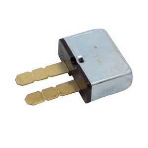

1 Red 10g to blower- use heavy orange that you deleted going out. Just come right off of the fuse panel. Back of FAN fuse port. Replace the 30 amp fuse with a 30 amp circuit breaker.

I like to run circuit breakers on the big circuits. Power windows and fans.

blower circuit wire (vintage air) 10g orange On this Orange 10g, I like to delete the engine side, pull it out of the firewall side of the bulk head, put a single GM (spare connectors and terminals from the AAW kit) and run it to the 10g Red to the Vintage air blower motor. I replace the 30amp fuse with a 30 amp ATO thermal relay. Remove the vintage air breaker from the system.
