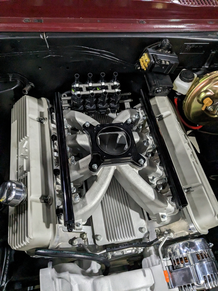

The LS3 came from Rydell and was on my floor the next day. They are great people to deal with. I'm liking the retro look LS motors so I went that route. I adapted some SBC valve cover mounts to Pontiac. It took 2 tries because the Holley ones were too tall and hit the brake booster.

I copied Mark with the coil mounts and adapted an electric fan to the stock rad.

Good looking engine.

Don’t make me 2nd guess myself. I have thousands into making a distributorless efi Pontiac that isn’t built yet. Something like this has been creeping into the back of my head.
Engine looks great and right at home in the engine bay.
