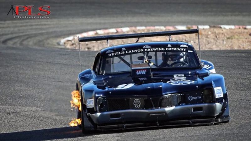

Extreme example

Extreme example
I don't know what that is...but it's really cool.

Extreme example
Cool stuff! I'd like to see a undercarriage shot of that car.
