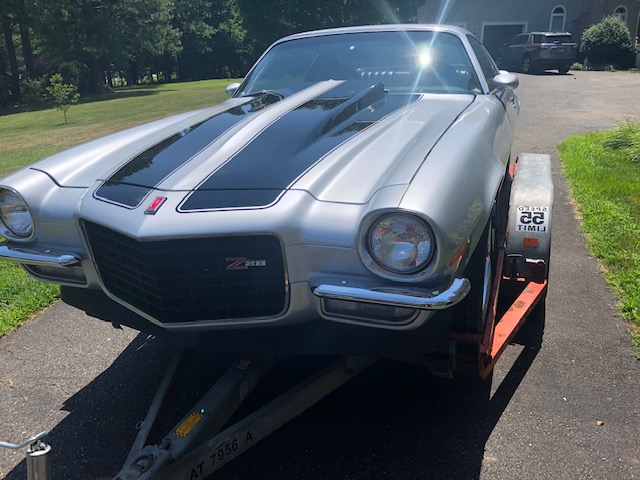

This 72 has a 350/350, gears M23 4spd and a 12 posi with 342 gears and a very solid body, interior is good for now and nice paint.
I have researched the heck out of these threads for 2nd gen Camaro’s and still a little undecided where I am going. I do know the chrome wheels are going and I need 275 x 18 on the front and would like 335/315 in the rear. A small block like something like the 600hp 427 FI Blueprint engine I had in my vette but open to carbureted as well but this time an automatic. The body and frame ares rust free and the paint and body work are certainly good for now but not very fond of silver. The only body work I anticipate are wheel tubs.
I am open for suggestions as I am going to tackle the suspension first. Looks like a four link set up is preferred but have seen keeping the leaf springs and there are several viable options out there. I need to change the rear gearing from 342, but will wait until I have my engine and transmission ideas. How much can the 12 bolt take with the c clips?
Note: I plan on doing some fun auto crossing and take it on the track for some fun road course stints but still want to hop in and drive with AC.
Many thanks as this will take some time 1(yr).

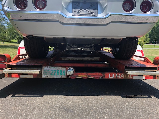

Ok I have 275's in the rear looking for suggestions to get more meat for the money underneath. Yes performance counts as well. Thanks

I believe you can get a 305 if you roll the fender lip and remove the rear seat belt bulge that's at the front of the well. How low you go with the ride height will have a huge effect on this, too. The fenders are draped/streched over the wheels. You can't go up into the well much at all before you're hitting the top of the well.
You can definitely fit a 305 or 315 if you do a DIY mini tub by cutting out the inner fender and moving it over just enough so that the inner part is flush with the the frame rail. Before DSE came along, this is how it was done. It's like a 2 or 3 inch widening. The design of the tubs is such that you end up welding in a flat sheet of metal, not a fancy contoured piece. Get under the car and look up into the wheel well and you should notice the frame rail sits to the inside of the tub and the top of the tubs where they are welded together is fairly uniform and flat. You're just moving the tub over enough to take advantage of the space that's available without cutting into the rail.
