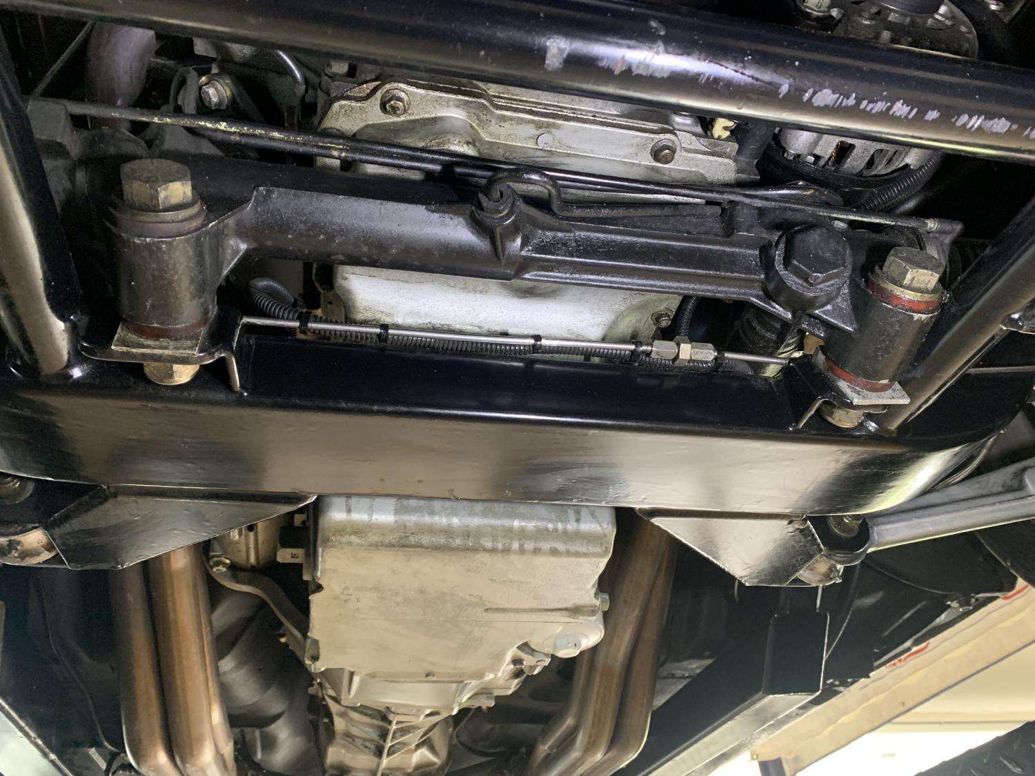

Old 04-01-2024, 08:50 AM
thedugan's Avatar
thedugan thedugan is offline
Join Date: Apr 2007
Location: NJ
Posts: 368
Thanks: 61
Thanked 132 Times in 86 Posts
Originally Posted by angrayson View Post
I just ordered a 22-207 rack, so we'll see if that works. I noticed the 22-207 has 15.5" mounting centers. Do you have to run a bushing offset kit on yours? My mounting points are 16".
Sorry long delay in responding. Finally got my car out of winter storage and on the lift. My rack measures 15.5.
I need to clean the underneath of the car....
