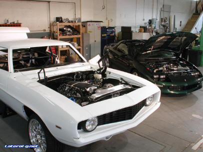

Mark gave me the go-ahead to put this article back online.
https://lateral-g.net/tech_articles/LS7_install
My LS7 69 Camaro

Is that oil tank same as ATS sells? Or is it longer ? I am asking it because Mark has notched the fender for it.

ATS is a dealer for Peterson. You can get Peterson dry sump tanks in 6", 7", or 9" diameters. You don't have a lot of room to get an 8 quart tank wedged in there. I had to do quite a bit of cutting. You'll definitely need a body saw.
Great! Because i want to drop it a little. It looks kind of cool when notched in to fender

It can't really be dropped a whole bunch or it will hit the lower valence/chin spoiler bracket. You also have to leave enough room to get the bumper bracket bolted on... and be very aware of where the tire is at full lock.
