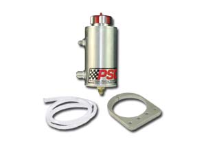

Looking for a remote reservoir with 2 return bungs, Does anyone have one available?

Why with two return bungs? Are you running a hydroboost? I'am curious?

Yes I am running a hydroboost.

You could use a Y connector.

My understanding is that with a Y connector you get turbulence between the steering return and the Hydroboost return due to the fact that they have different prssures.

just add a bulkhead AN fitting in your reservoir up high. That's what I and most others are doing, works great.

Who's reservoir are you using? Billet Specialties has the return tube inside so is it O.K. to add another bung?

I used the SR-102 from http://www.pscmotorsports.com/

mine is the factory late-model pump with reservoir on the pump; there is one return line in the side and I drilled and added a second to the back up top near the cap.

Thanks Steve, i just ordered one from them. Are you autocrossing in S.Falls this weekend?
