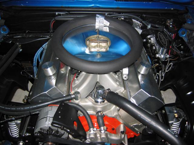

A few more photos uploaded to photobucket, including engine shots.
http://s447.photobucket.com/albums/qq198/rob07002/

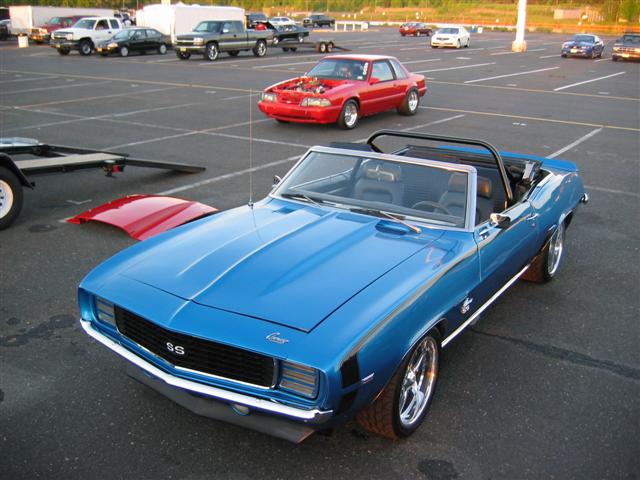

Now if it would just stop raining for a day, maybe I could do some driving!
Here's my favorite so far.
