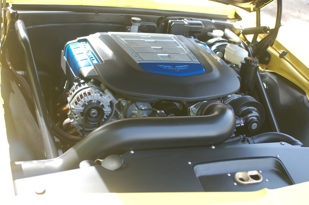

Just picked up JA from Reiter's. The guys did a killer job. I'm very happy with their attention to details.
JA travels in style on the best U-Haul has to offer
Luckily my girl friend Laura has a tow vehicle. Too bad she works for Ford.
Engine bay all squared away
