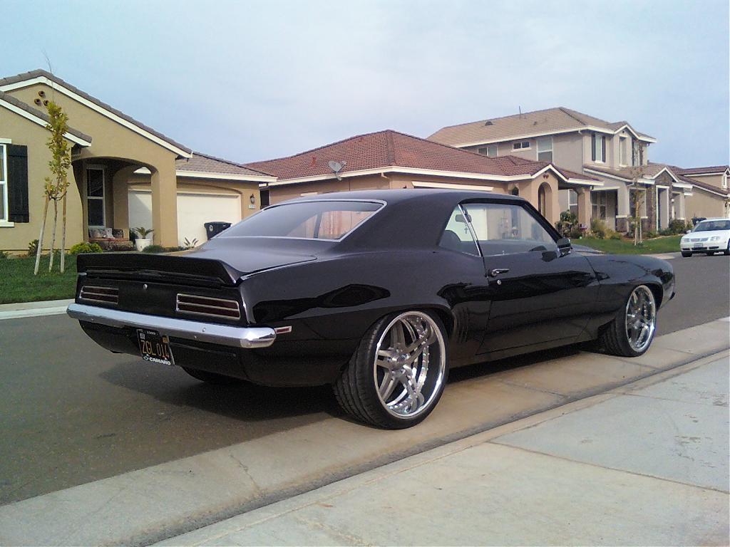

Here is my 69 with 285-30-20 on 20x10, b/s 5.625 and rolled outer fender lip.

dang that is sweet.
