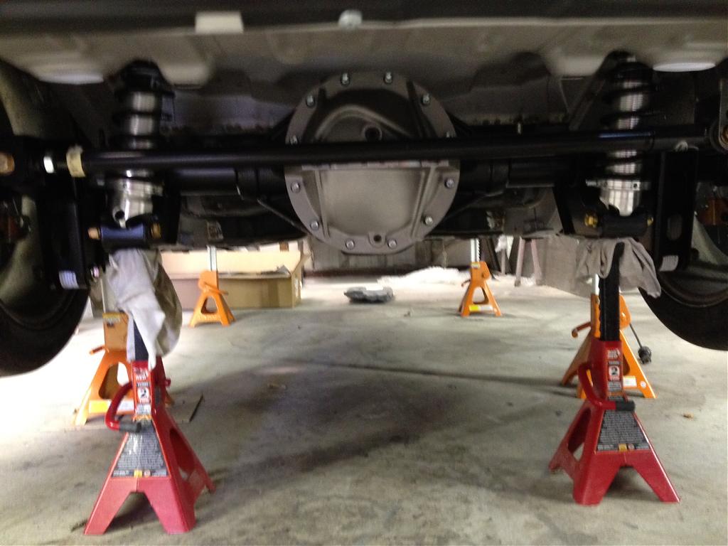

I stopped by Mikes shop today to see the car, and its really starting to come along. I can't say enough good things about his knowledge and skills. Here is a few pics.

Thanks Matt, I got more photos of the carnage I will be posting later tonight. Disregard the angle of the shocks in Matt's pic, the upper brackets were not welded in place yet.
