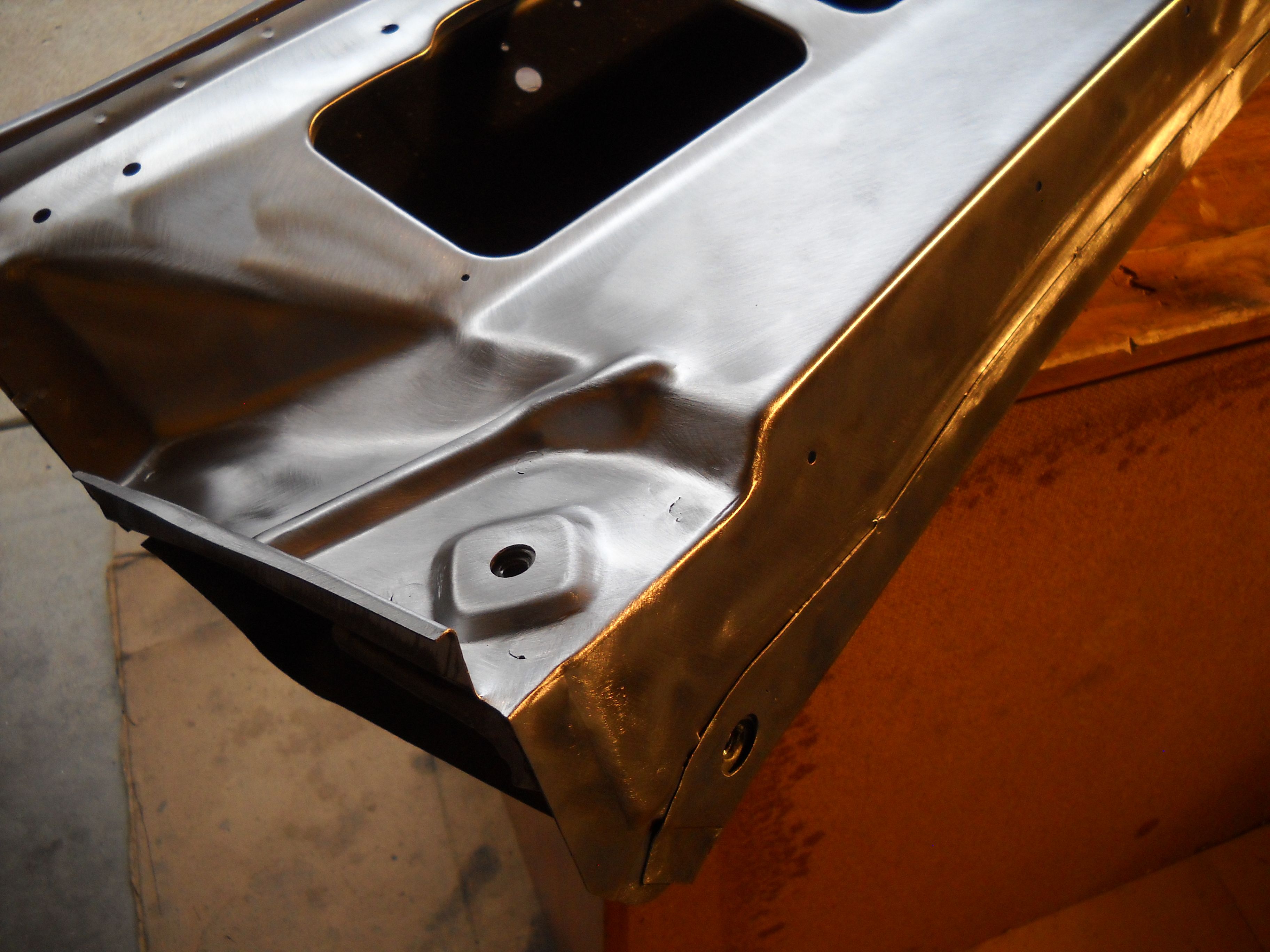

Hey thanks 67goatman455 ... my motivation comes from wanting to drive my Camaro I am realistic and know not everything will work the first time and that's hot rodding, but I'll do my best to minimize the down time by doing it right the first time.
Got the cowl finished today and I thought maybe I'd be able to spray epoxy later but the wind is kicking and it's spitting again ... maybe tomorrow.
Finished the cowl.
Little finish work left.
I still need to weld the OEM brackets and wiring hold downs to the new cowl, it's always something huh
