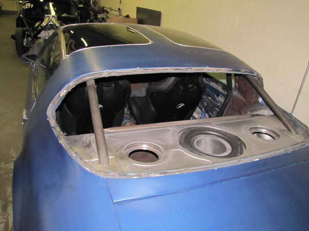

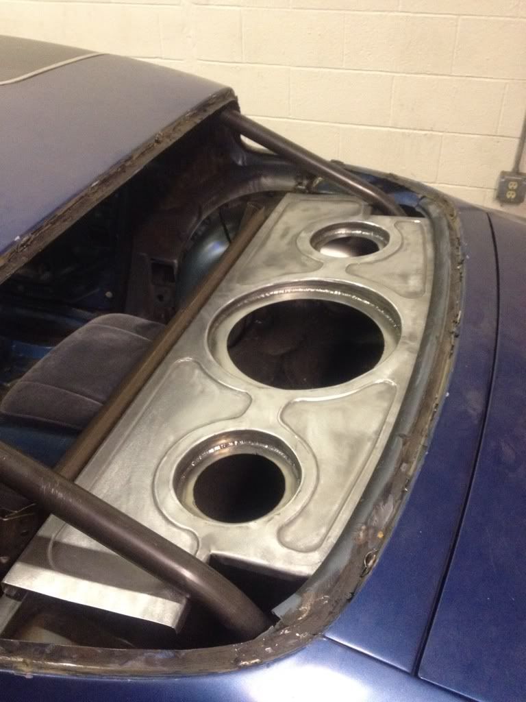

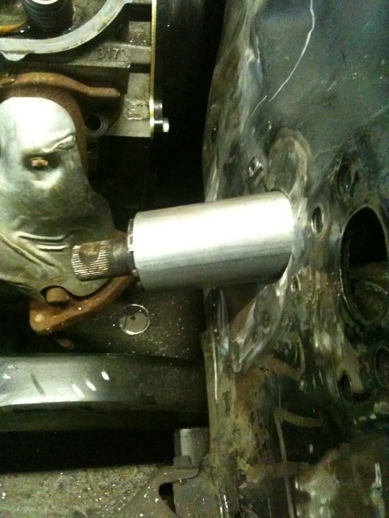

Some progress has been made, been collecting parts as well.
Shaved steering column and steering shaft is done, rear seat, and package tray is done, but still waiting on the watts link. Been collecting parts as I now have my speedway swaybars, Precision 6262 turbo's, and some Anvil carbon parts.

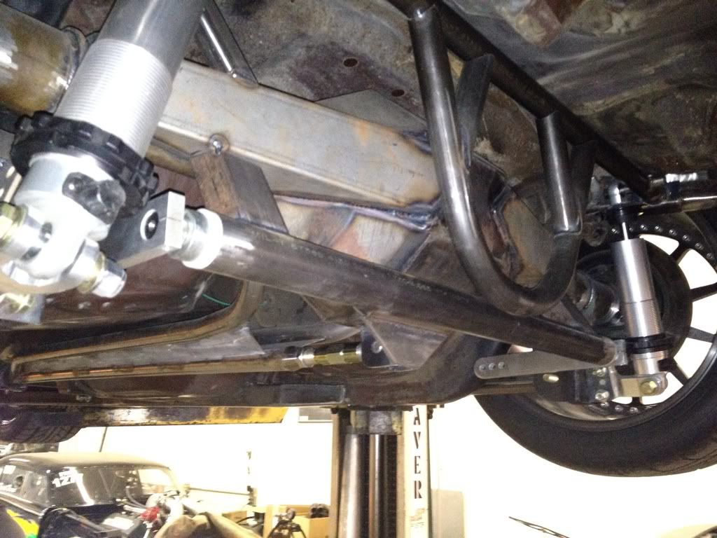

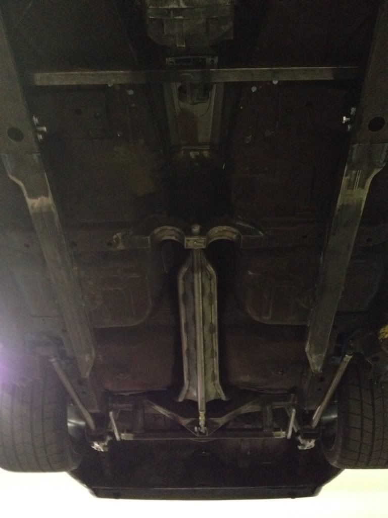

417 got some more work done to the car. Through the floor subframe connectors are done along with the sway bars. The watts link is started, hopefully it will be done soon.

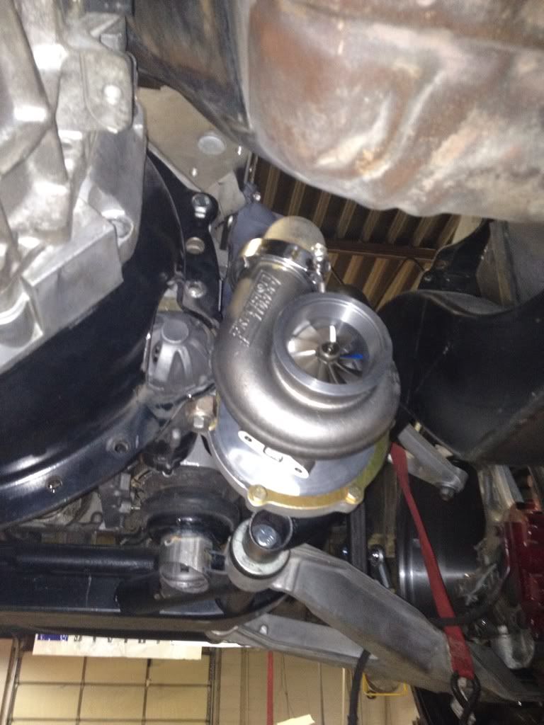

Posts: 149

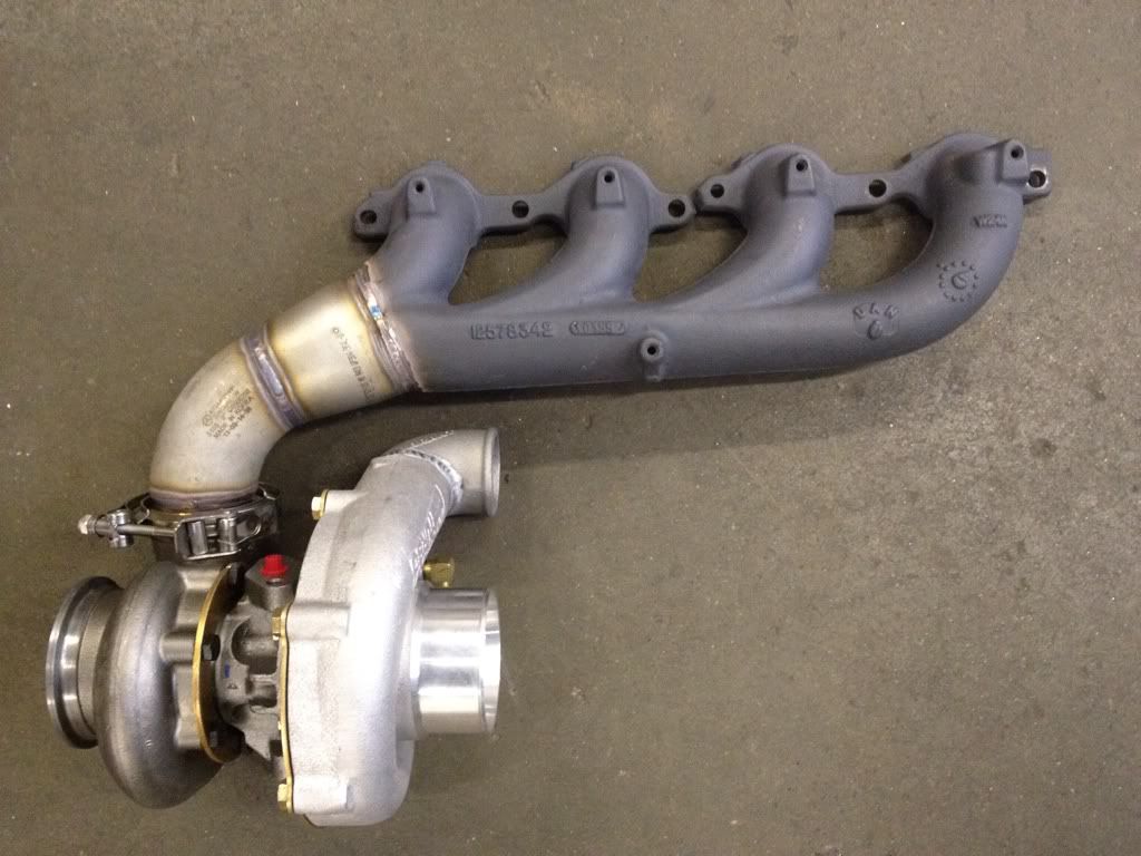

here is the start of the twin turbo kit. We are keeping it low and as far back as we can for functionality.
Stock 6.0 truck manifolds.
Turbo's are precision 6262 billet wheel with v-band inlet and outlet on the exhaust side.

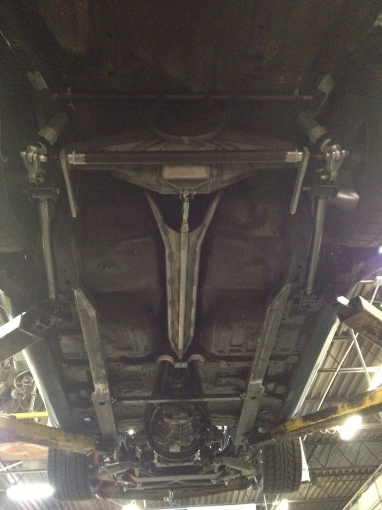

Progress had been a little bit slow, but the chassis is done now and I brought the car home middle of last week. Car will go off for body work next then start the wiring and assembling!
here are a couple pics of tranny crossmember and watts link and the car finally at home.
