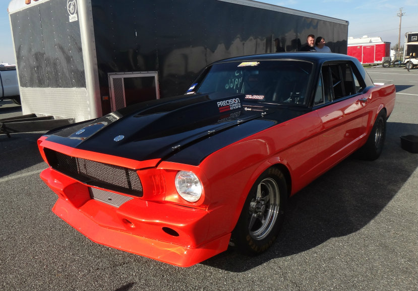

This car consistently runs mid 8's on our gLink rear suspension when he puts on slicks It has double adjustable VariShocks and a FAB9 housing too. Read about it here.
And here's a link to the car on StangTV.

Nice mustang.. for rear suspension Eval 60 foot is often a lot more important the ET.
