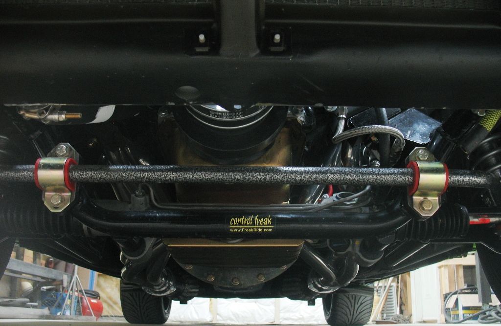

This is our third Control Freak IFS for Mopars, and we love their product!

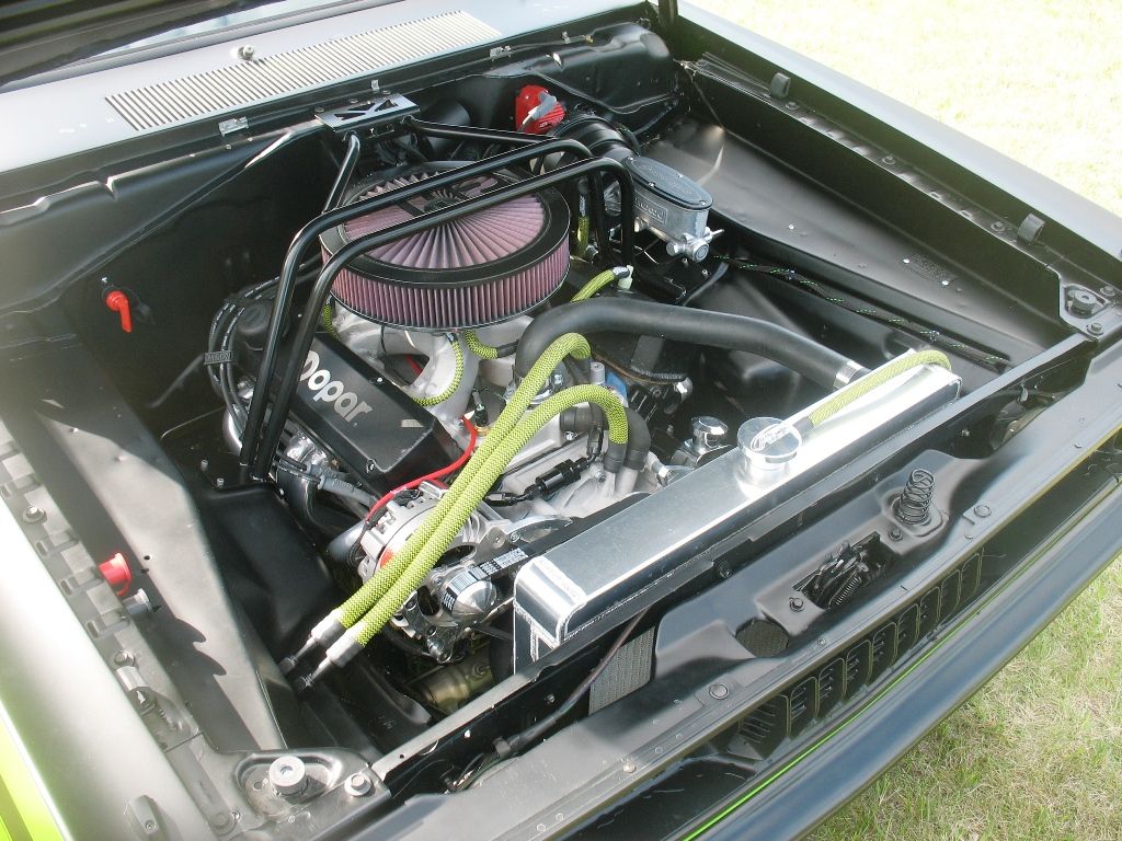

Just a bit of hood clearance, seems the Air Gap intake is just a bit too high. If we didnt use the Xstream air cleaner top we could have avoided it.

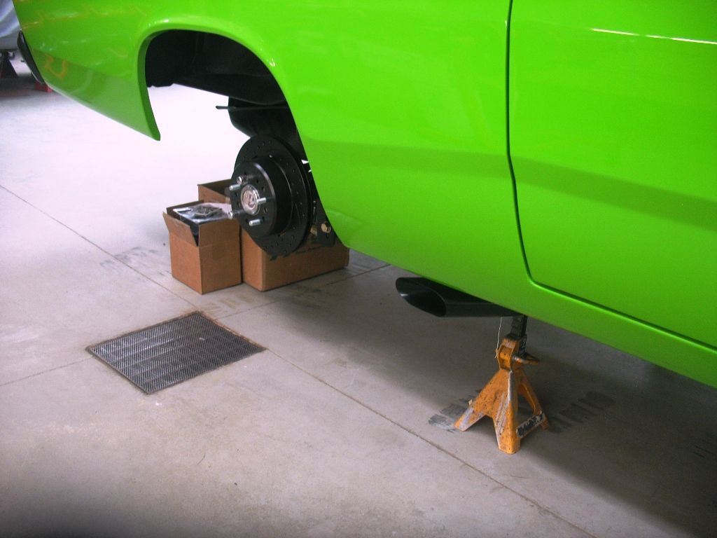

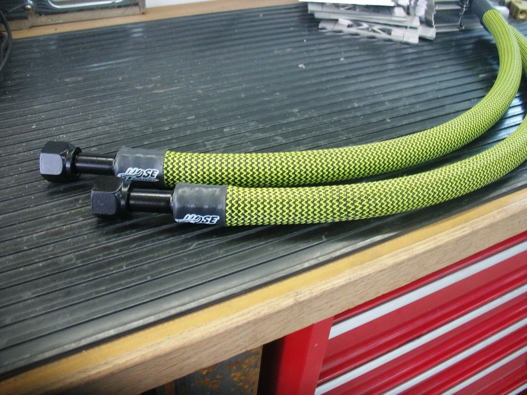

How about some Hose Candy!
The suspension installed

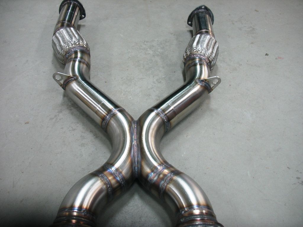

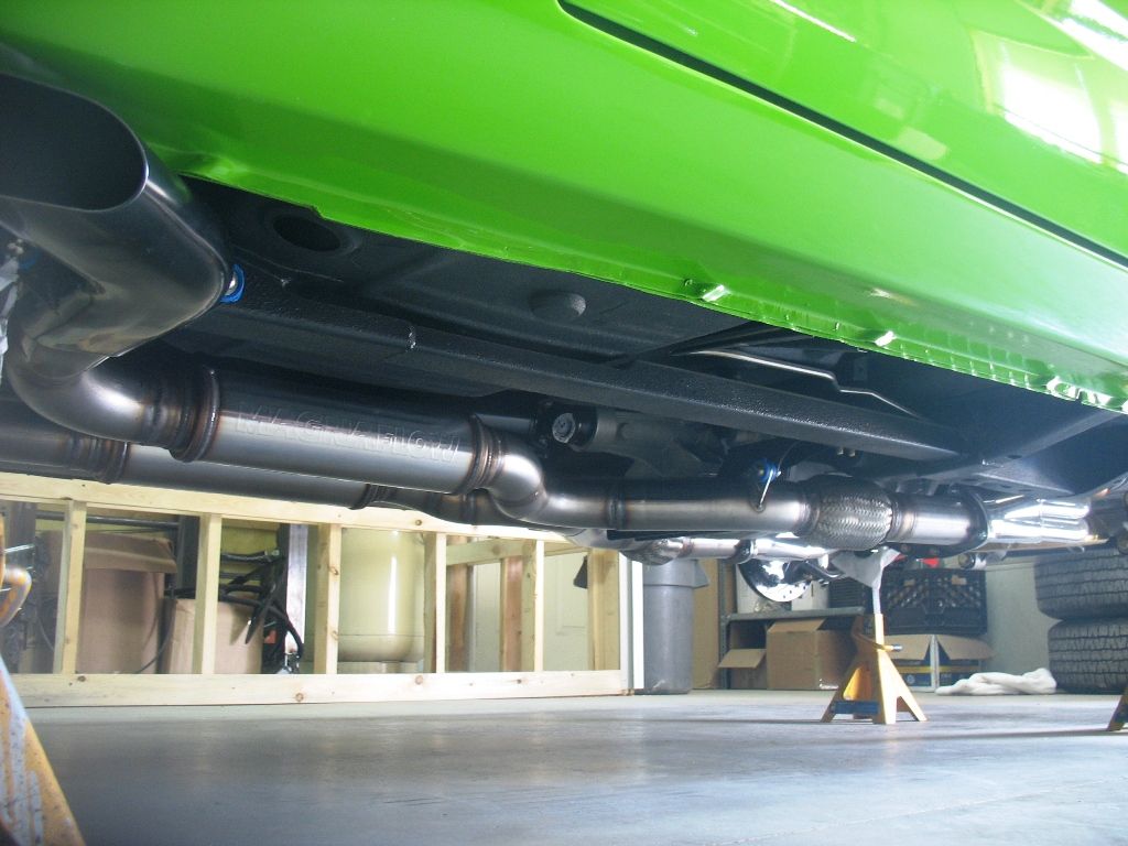

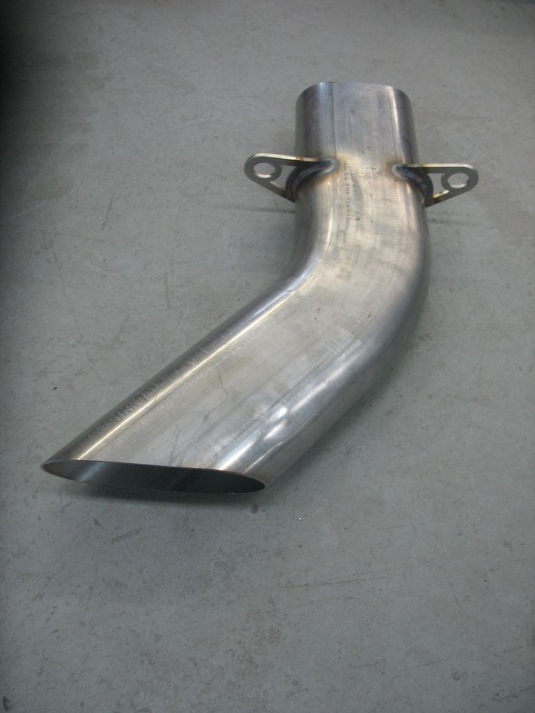

Everyone loves TIG'ed stainless!
Some custom side exit exhaust tips that are now satin black
Nice and short exhaust....he said he wanted it to scare women and small children!

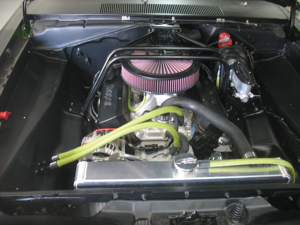

Oh yeah, its Sassy Grass Green!
Engine bay
