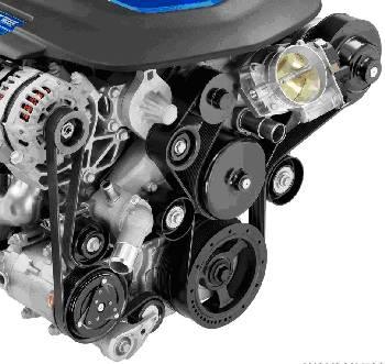

Originally Posted by 68LS1 View Post
Where does the position A/C compressor?
Up top, passenger side.

Originally Posted by dhutton View Post
The Vintage Air Front Runner they sell does not require the notch....
Don
Vintage Air Front Runner will not work with blower drive. LS9 accessory drive packages AC compressor passenger side low. It and generator are driven by one belt (6-rib), while SC, H2O pump, PS pump are driven by 2nd belt (11 rib).

Originally Posted by formula88 View Post
Mark pocketed the cross member near the RH engine mount to provide clearance for the AC compressor.

Originally Posted by Payton King View Post
This question is going to seem to come out of left field...what injectors are you running in both Hell Fire and JA 2 ? I am looking for an injector to support 800 hp NA and did not know if the GM injector is up to the task.
I have looked at this injector as well
http://injectordynamics.com/injectors/id850/
Thoughts?
I'm pretty sure he's using fire hose nozzles. I could be mistaken though.
