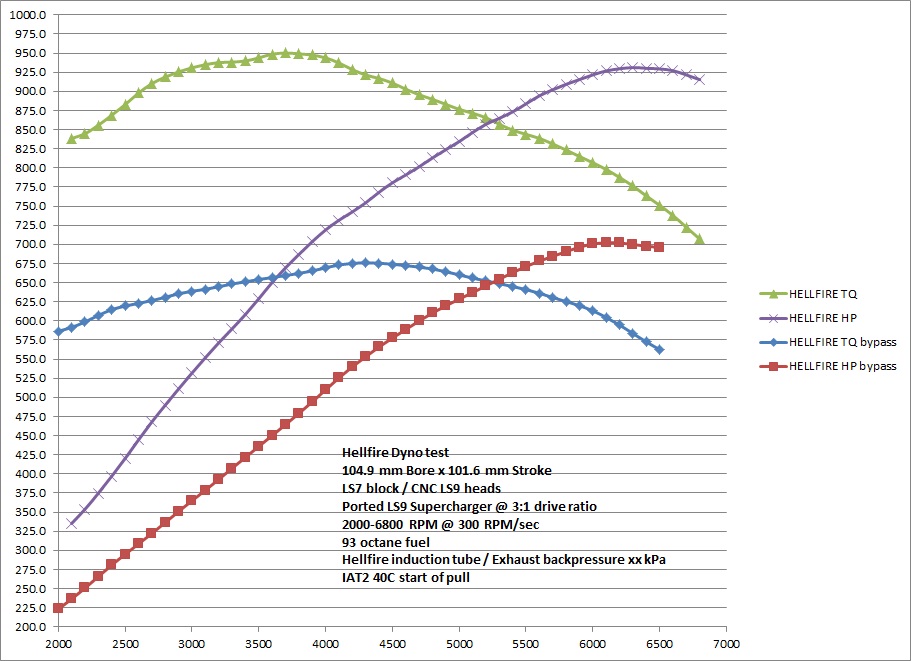

One small problem, it will still put a hurt on the tires in 4th gear with that tune.
Well, maybe not with the boost bypass open.
Bypass open makes 'only' 700hp/675tq......
