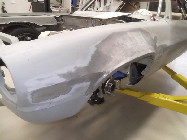

I hear that!!! Freakin' grinder!!! Wish I was better with the TIG so I didn't have so much grinding to do!!

First flare metal work at 95%, a touch more hammer/dolly/shrink work to be done...might enlist some help from a sheet metal voodoo expert to get me closer here but right now 1/16" of filler would get me smoooooth! I think an expert could get me closer. Truth be told, I was impatient more than once while welding this up, and put to much heat into a couple areas. Totally fixable, just angry that I added work to my plate.
